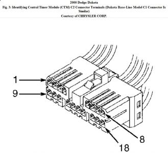

Without the physical vehicle I would not dare to promise you anything but we can give it a try and hopefully get it resolved.
All the components described are connected to the Central Timer Module ( behind right siode of dash). Try unplugging it to see if the fuse blows. I believe it should be related to this and we shall start with it first.
Which fuse is blowing? There are 2 fuses for the power door locks, driver and passenger door locks uses different fuses.

The CTM is located between glove box and right front pillar A. I am not able to find any diagrams to show you the CTM or its exact location. The only thing available is a wire connector which is as shown in the diagram.
https://images.2carpros.com/forum/automotive_pictures/192750_CTM00DakotaFig03_1.jpg

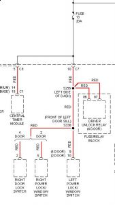

it is fuse number 13 20 amp pwr locks
Jan 2, 2010 at 5:21 AM
KHLOW2008
  • 41,814 POSTS
Here is a diagram of what components utilises the fuse. Try unplugging all the components listed and reinstalling each one to see which component causes the fuse to blow.
https://images.2carpros.com/forum/automotive_pictures/192750_DrLock13Fuse00Dakota_1.jpg
