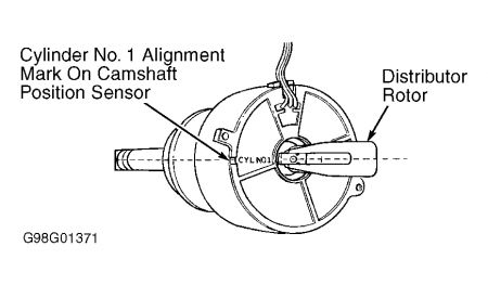

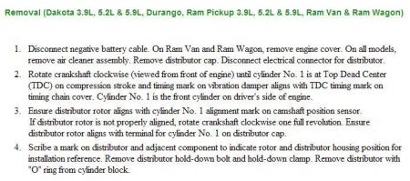

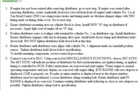

I am wanting to replace my cap and rotor on my dakota feeling that it is just necessary maintenance. Mileage = 135000 and year is 2000. I would like to know how accessible and easy this is and a quick rundown of steps to follow. Thanks in advance.

https://images.2carpros.com/forum/automotive_pictures/261618_Noname_1487.jpg
https://images.2carpros.com/forum/automotive_pictures/261618_Noname2_435.jpg
https://images.2carpros.com/forum/automotive_pictures/261618_Graphic_275.jpg
