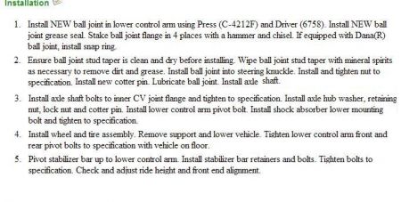

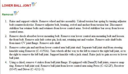

1999 Dodge Dakota replace ball joints
LMOSEBAR
Suspension problem
1999 Dodge Dakota V8 Four Wheel Drive Manual 191.00 miles
replace lower ball joints
Jun 26, 2009 at 6:43 AM
BLUELIGHTNIN6
  • 16,542 POSTS
https://images.2carpros.com/forum/automotive_pictures/261618_Noname_587.jpg
https://images.2carpros.com/forum/automotive_pictures/261618_Noname2_152.jpg
