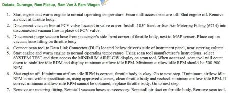

Having trouble adjusting IACV. I have bought a new replacement. It either revs 3000 rpms or too low and dies. What are all steps to correctly adjust new IACV

there is no adjustment for the IAC motor/valve, you can adjust the throttle body airflow though. follow steps below..
https://images.2carpros.com/forum/automotive_pictures/261618_Noname_2640.jpg
