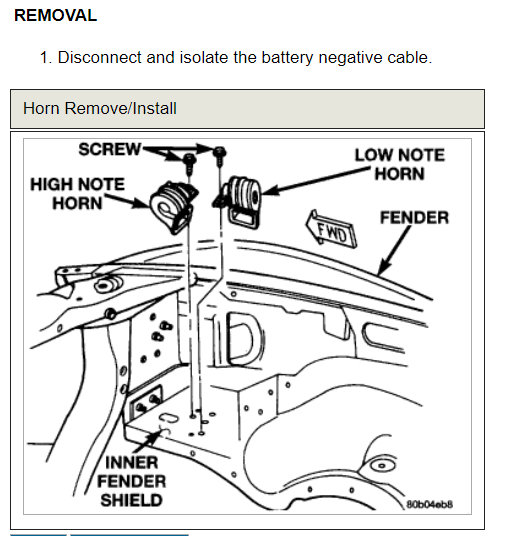

I need to know how to repair my horn i doesn't work I checked the the fuses if it is a wiring issue how can do it

I would use a test light to check for power at the horns and go from there here is a guide to help you do the test.
Here is the horn location (below)
