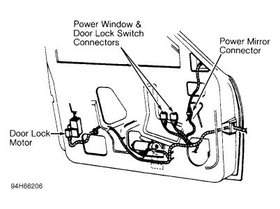

i own a 1999 dodge dakota sprot club with four wheel drive and 318 engine with four wheel drive. The door power door lock on the driver side makes a grinding nosie and will not lock either by the door switch or the remote. how can i fix this problem?

DOOR MOTOR Removal & Installation Roll door waterdam away from lower rear corner of door to expose inside panel access opening. Disconnect door lock motor connector wires. See Fig. 3 . Remove door lock motor link at door latch. Remove door lock motor mounting bracket screws. Remove motor assembly from door. To install, reverse removal procedure. Fig. 3: Locating Power Door Lock Motor
https://images.2carpros.com/forum/automotive_pictures/266999_door_4.jpg
