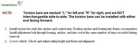

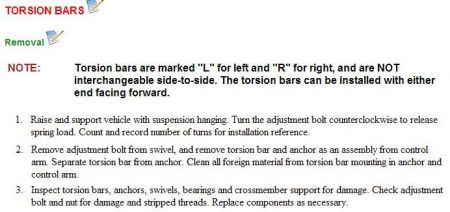

1998 Dodge Dakota 6 cyl Four Wheel Drive Automatic
i was wanting to know how 2 remove and install my torsion bars. Because i was wanting to put torsion bar keys on my truck but i do not know how to remove the torsion bars. can you help me?
