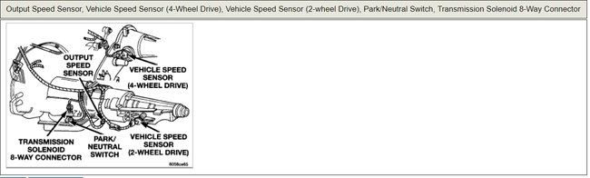

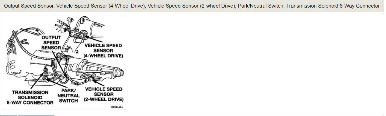

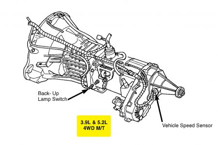

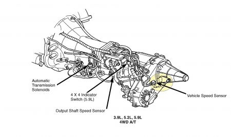

My speedometor does not work and the OBD system says it is the speed sensor. Where is the speed sensor located and what does it look like?
May 10, 2008 at 9:53 AM
MASTERTECHTIM
  • 4,750 POSTS
Here is a diagram that shows the VSS located on the rear of the transmission

Here it is on a 4x4
https://images.2carpros.com/forum/automotive_pictures/99387_dakota_man_tranny_1.jpg
https://images.2carpros.com/forum/automotive_pictures/99387_dakota_tranny_1.jpg
