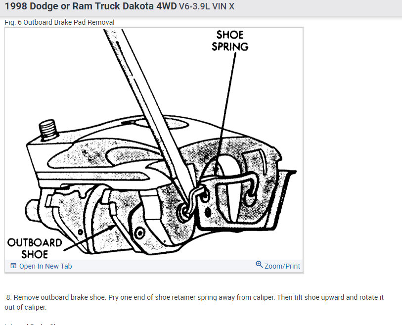

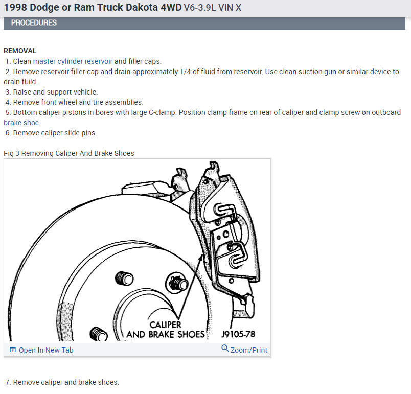

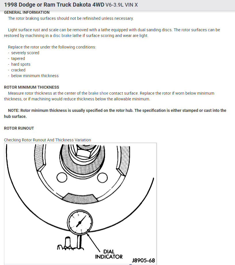

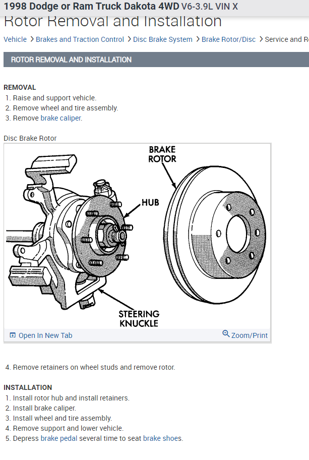

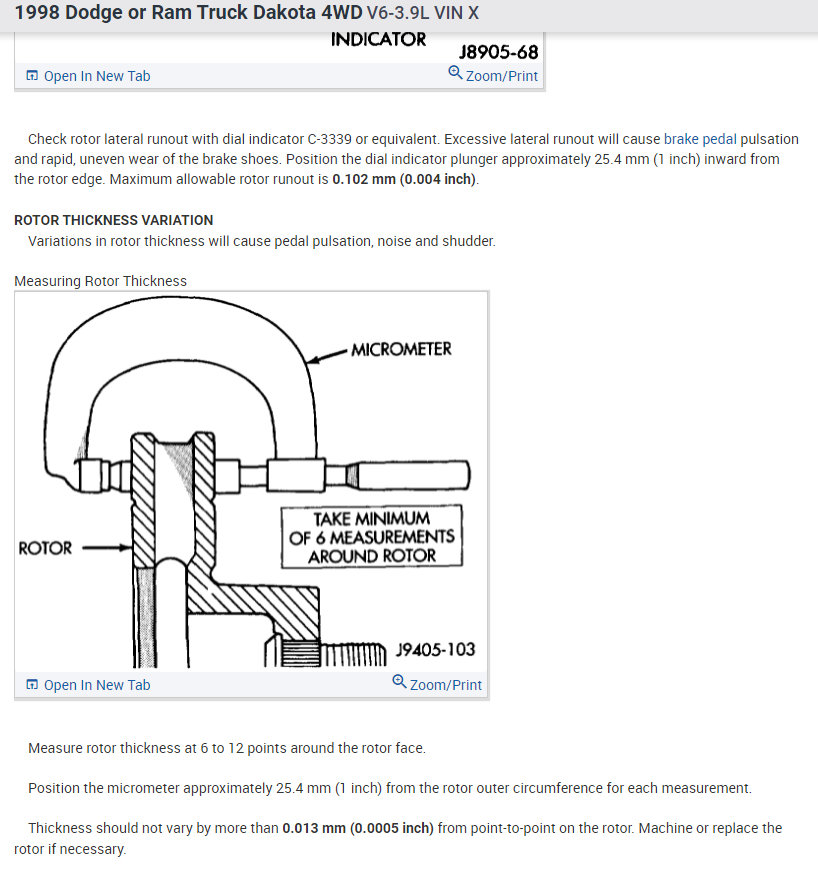

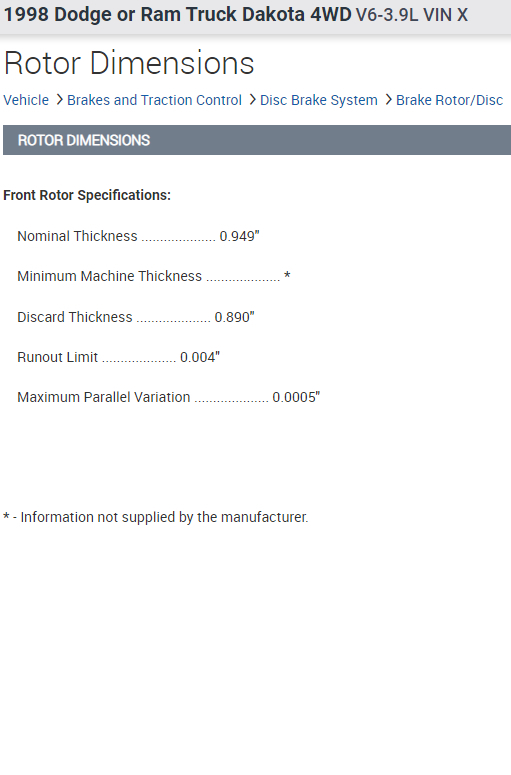

Does it shake when you apply the brake?
If so you could have wrapped brake rotors.
As you apply the brake the vehicle will shake because of that. The rotors can wrap if they wear off below the minimum thickness or simply for everyday use.
You can check to see if they are above the minimum specifications, if you will be able to have them resurfaced as your local auto parts store. When you resurface or replace the rotors, it is recommended to replace the pads as well.
