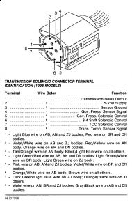

This is only picture I could find of solenoid connector, could not find pic of shift solenoid.
https://images.2carpros.com/forum/automotive_pictures/108325_dakota_1.jpg
