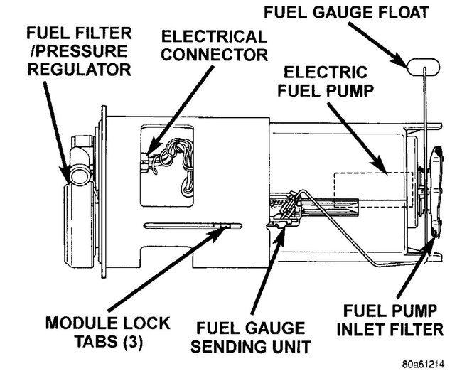

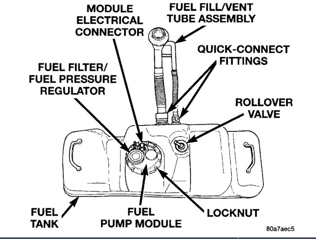

P0463 Fuel level sensor high input code
12,500 MILES • V8 • 4WD • AUTOMATIC
DURADUK
Also, at one point the fuel guage went to zero. Added 9 gal's of fuel and went to normal.
This truck sets a lot but I leave the tank full.
Runs very well otherwise.
What do I need to do to further diagnose and repair this issue.
Thanks
Apr 14, 2008 at 3:52 AM
  • 55,612 POSTS
Your fuel level sensor (Tank Unit) is shorting out, replace it to repair this problem. Please get back to me when the repair has been made.
https://www.2carpros.com/articles/how-to-replace-an-electric-fuel-pump
See the pictures below for location
