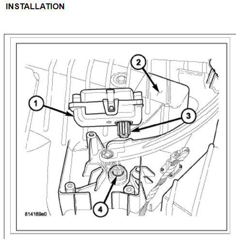

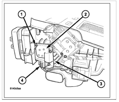

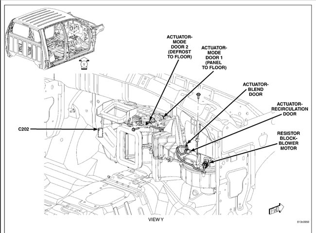

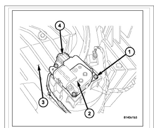

I am getting cold air, but it is only blowing through the defrost vents and not through any other vents either on the dashboard or the floors. What do i need to do?
Aug 22, 2009 at 12:30 PM
SAFARI1988
  • 8 POSTS
It sounds like you need to replace the mode actuator motor here is a guide to show you what you are in for when doing he job and diagrams below to show you the location for your car.
