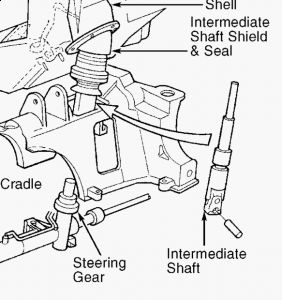

Steering problem
1997 Dodge Dakota 6 cyl Two Wheel Drive Automatic
There is a u-joint in the steering just before the steering gearbox. What is this part called? And how do I replace it?
Saturday, January 9th, 2010 AT 11:21 PM
MERLIN2021
MECHANIC
17,250 POSTS
Called intermediate shaft, remove the pinch bolts at both ends, collapse the shaft and remove.
