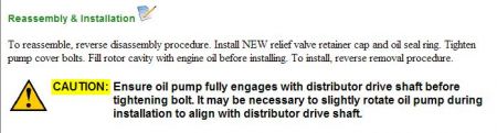

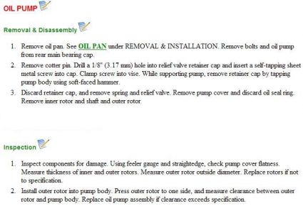

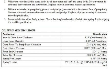

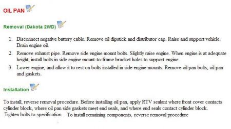

how do i remove the oil pan, so that i can remove the oil pump and clean the oil pan of sludge?

https://images.2carpros.com/forum/automotive_pictures/261618_Noname_1687.jpg
https://images.2carpros.com/forum/automotive_pictures/261618_Noname2_531.jpg
https://images.2carpros.com/forum/automotive_pictures/261618_Noname3_205.jpg
https://images.2carpros.com/forum/automotive_pictures/261618_Noname4_102.jpg
