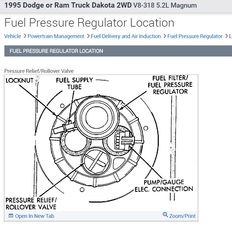

where is the fuel pressure regulator location?
1995 DODGE DAKOTA
104,000 MILES • 6 CYL • 2WD • AUTOMATIC
KINYON

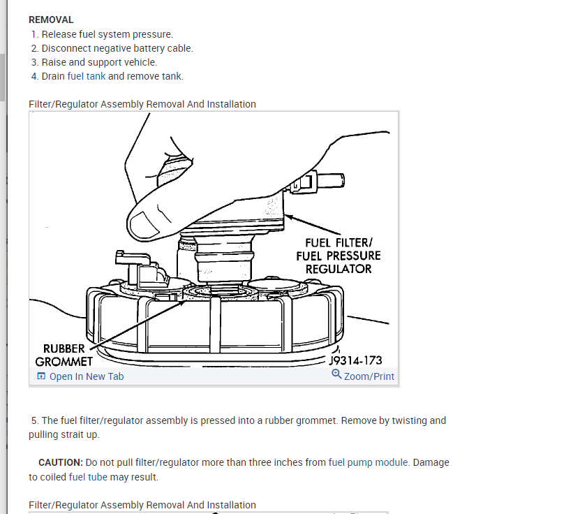

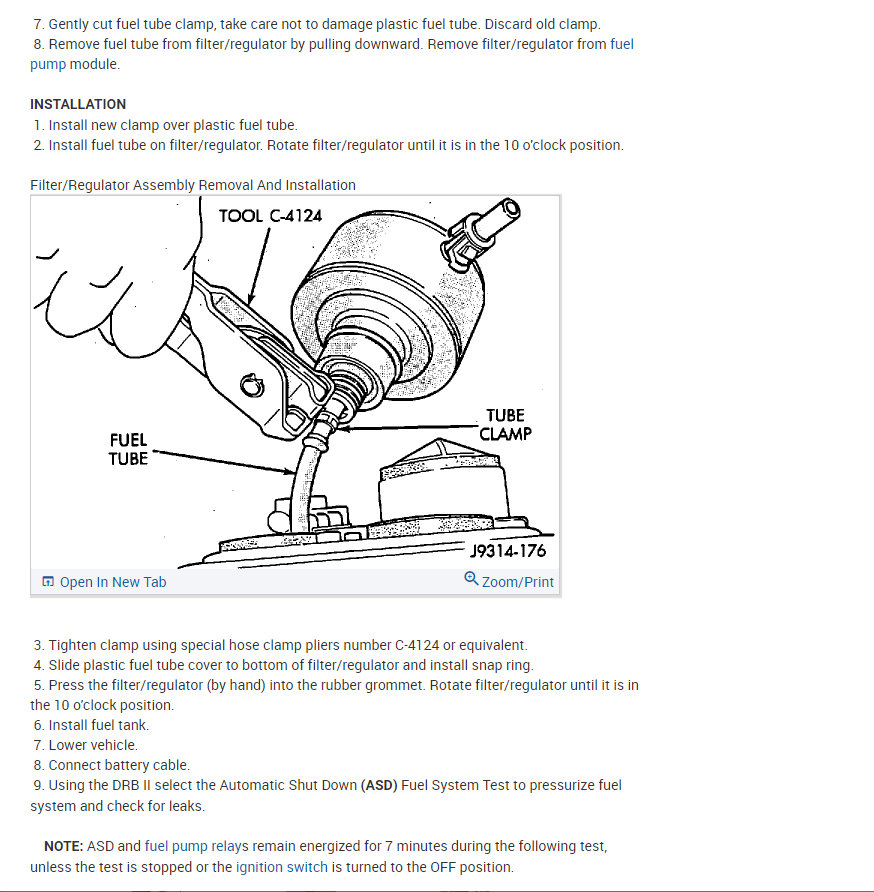

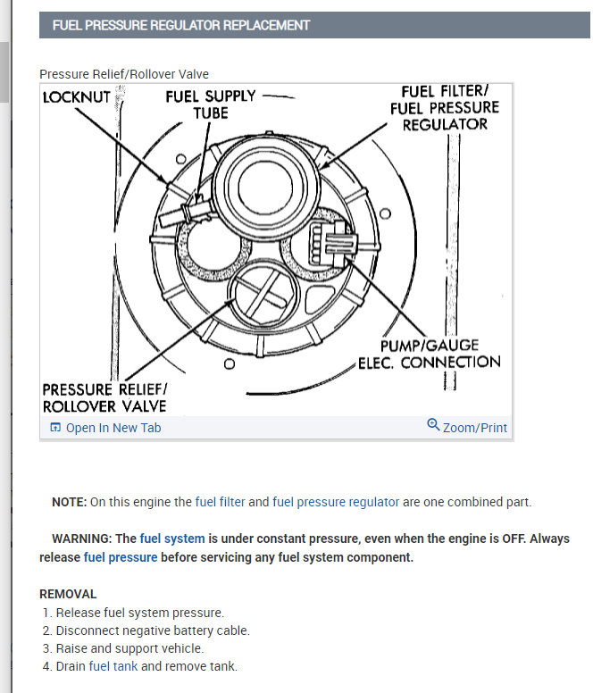

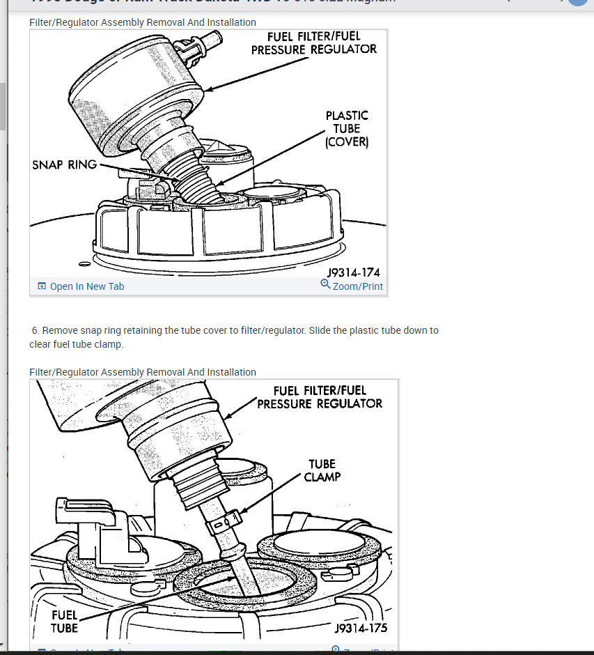

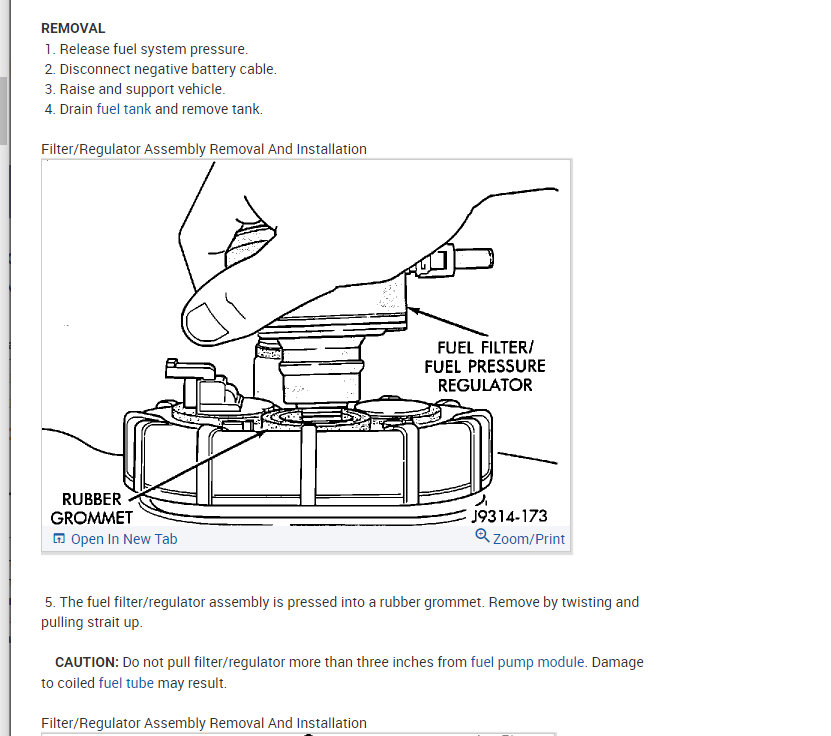

is the fuel pressure regulator on the fuel pump in the gas tank?
Feb 3, 2009 at 11:25 AM
BMRFIXIT
  • 19,053 POSTS
The fuel pressure regulator is at the top of the fuel pump combined with fuel filter mounted in fuel pump module in fuel tank. Check out the diagrams (Below). Please let us know if you need anything else to get the problem fixed.

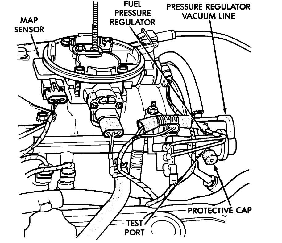

The regulator on this vehicle located on the pump in the tank. I included the info on this for your review.
However, before you condemn this, I would suggest testing the pressure using this guide.
Please run through this info and let us know what you find with this. Thanks

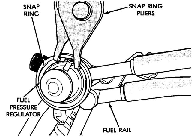

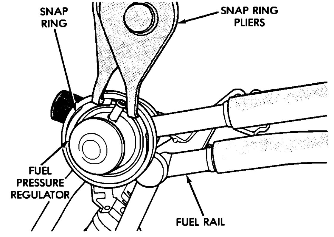

The regulator is located on the end of the fuel rail and held on via a snap ring. I'll post some pictures below.
It sounds like you may have low fuel pressure. With the key on and engine not running you should have 31psi. With the engine running and vacuum line to regulator plugged it should be 39psi minimum at idle.
WARNING: The fuel system is under constant pressure, even when the engine is OFF. Always release fuel pressure before servicing any fuel system component.
REMOVAL
1. Release fuel system pressure.
2. Disconnect negative battery cable, and remove air cleaner assembly.
3. Disconnect vacuum hose from throttle body.
4. Using snap ring pliers, remove snap ring and pressure regulator.
5. Remove O-rings from regulator.
INSTALLATION
1. Install new O-rings on regulator.
2. Push regulator into fuel rail, with vacuum nipple pointed straight up.
3. Install snap ring.
4. Connect vacuum hose to regulator.
5. Connect negative battery cable, start engine and check for leaks.
6. Install air cleaner assembly.
