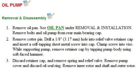

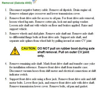

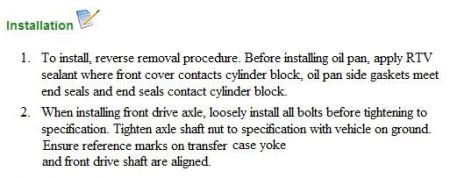

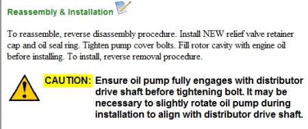

What is the easiest way to replace the oil pump

BLUELIGHTNIN6
MECHANIC
16,542 POSTS
+1
Wednesday, March 31st, 2010 AT 2:21 PM
