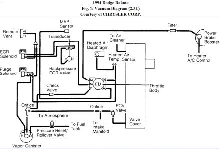

1994 Dodge Dakota vac.hose's
1994 DODGE DAKOTA
180,055 MILES • 4 CYL • 2WD • MANUAL
SUSANASHLEY
rebuilt the engine and can't find were all vac., hose go can u send me a digrame I can read
Apr 8, 2010 at 8:23 AM
MERLIN2021
  • 17,250 POSTS
Here's the diagram for 2.5 engines, this is how they look, reading is up to you!
