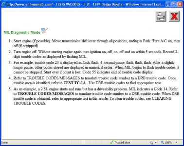

When you say no information on code's did you have it tested for code's and there were none?Or did you not have it tested for code's and you don't know if there are any code's?If you haven't had it tested for code's it would really help if you did if there were code's it code save us a lot of time of not having to test everything in the ignition system. We will work on the no spark first. Also why do you think it seems to run hot even though the gauge reads normal?Let me know.

I don't have axxess to a code tester. I guess I should have just gone to a good mechanic and had it tested.

https://www.2carpros.com/forum/automotive_pictures/416332_1994_dodge_dakota_code_retrival_1.jpg
Lets see if this works i didn't see the manual way of getting code's before.Give it a try let me know if it work's.

I came up with codes--- flashing at 32 - 33 - end 55. Hope this info helps you to help me. Thank you

The 33 is egr system failure and the 34 is egr solenoid circuit.55 just means that was the end of the code's so not alot of help with no spark. Lets start with fixing the spark first then we will worry about other thing's.I emailed you the trouble tree for no spark check it when it get's hot and has no spark.
