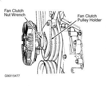

Can you replace a fan clutch without removing the radiator shroud? If not how the heck do you get that shroud off? I've been trying, seems like you'd have a lot more room.

Have to remove fan before the shroud so no need to remove shroud 1st
https://images.2carpros.com/forum/automotive_pictures/99387_fan_clutch_6.jpg
