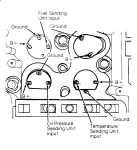

Hello - Thanks for the info....... Let's start with the fuel pump.............I have the test below......try to retrace putting the fuel pump in.......the sending unit is attached, the float etc.......it may be in a bind...are you sure all electrical connection were connected? Do the test and see what you find there............. FUEL GAUGE & FUEL TANK SENDING UNIT TEST NOTE: DO NOT leave sending unit lead grounded for extended periods; gauge damage will result. Dakota 1. Test fuel gauge and wiring by grounding fuel tank sending unit lead. Turn ignition on, and note gauge reading. DO NOT leave sending unit lead grounded for extended periods; gauge damage will result. 2. If gauge indicates maximum reading, wiring and fuel gauge are operating properly. Go to step 4). If gauge does not indicate maximum reading, remove gauge. Using a voltmeter, check for battery voltage between B+ pin and ground pin. See Fig. 1.
https://images.2carpros.com/forum/automotive_pictures/248015_F1_8.jpg

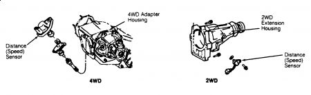

Fig. 1: Identifying Instrument Panel Gauge Pins (Dakota) Courtesy of CHRYSLER MOTORS. 3. If voltage reading is not as specified, check wiring connections and instrument panel printed circuit board continuity. If wiring and circuit board test okay, replace fuel gauge. 4. If gauge indicates maximum reading in step 2), remove fuel tank sending unit. Connect a jumper wire between sending unit body and chassis ground. Install sending unit harness connector. Move float arm to FULL, then EMPTY position. Note fuel gauge readings at each float arm position. Allow at least 2 minutes at each test point for gauge to stabilize. 5. If no reading or improper reading is obtained at either test position, replace sending unit. If sending unit tests okay, check for damaged ground wire or poor connection. Ensure float assembly does not bind in fuel tank and tank is not damaged. Repair as required. Was the fuel and tach working prior to the tanny R&R? Code 15 is NO VEHICLE SPEED SIGNAL No Distance Sensor Signal Detected During Road Load Conditions. That is located on side of the transmission.....check the connections...the sensor may be defective.
https://images.2carpros.com/forum/automotive_pictures/248015_sensor_1.jpg
