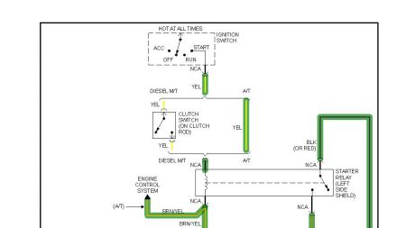

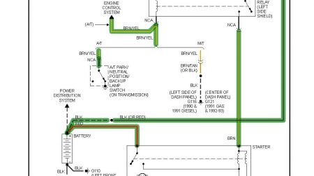

Wire off starter broken, may have blown a fuse. when jumping the terminals on the starter with key on engine will start, repaired wire and can not find fuse, ignition fuse and relay still work but engine will not crank.
Mar 29, 2008 at 9:57 AM
  • 75,992 POSTS
See wiring diagram below
