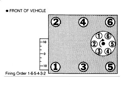

need a diagram of firing order from motor to rotor

Here is a picture for you.
https://images.2carpros.com/forum/automotive_pictures/249084_firing_2.jpg
Let me know if it helps. If you have other questions, let me know. Joe
