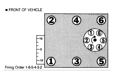

Docfixit thanks for your response before. A 3.9l what should the pressure from the fuel pump be? and is there a difference in the firing order from a 3.0? Thanks again Sky Dog
Nov 10, 2010 at 4:24 AM
DOCFIXIT
  • 18,828 POSTS
Hi Timing not adjustable controled by computer Fuel pressure 14.5 psi firing order
https://images.2carpros.com/forum/automotive_pictures/198357_Graphic_706.jpg
