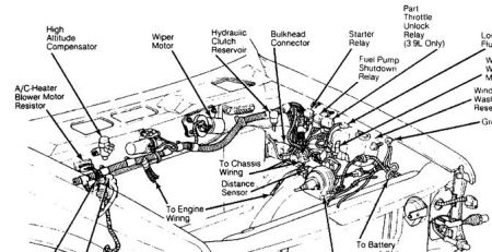

Were is the fuel pump relay and how do you test it. Okay I figured out how to test it but I still don't know where it is. Can't find it in the book. The reason I ask is because the truck has spark but no gas gets up in the carburator. I want to rule every thing out before assuming the fuel pump is bad.

Welcome to the forum, thanks for the donation. The relay should be under the hood, driverside fender lining. Voltage for load side of relay is hot all the time. Voltage and ground for coil side of relay is control by computer. Check voltage and ground for relay coil, with engine cranking. Are there any codes?
https://www.2carpros.com/forum/automotive_pictures/170934_dakota_fuel_pump_shutdown_relay_1.jpg
