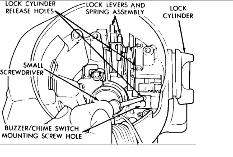

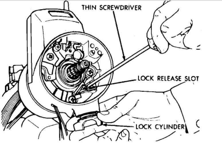

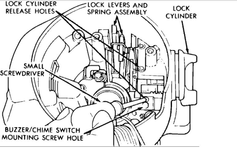

I need to replace the ignition lock cylinder and have removed the steering wheel and the turn signal hazard warning switches. My manual shows a lock release slot which I cannot find.
Jan 22, 2010 at 6:31 PM
  • 54,841 POSTS
You will need to remove the steering wheel before you begin. Here is a guide to help you see what you are in for but yours will need a puller
https://www.2carpros.com/articles/steering-wheel-removal
Here is some guides that show you how to change the ignition lock (below)
Please let us know what happens so it will help others.
