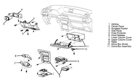

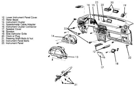

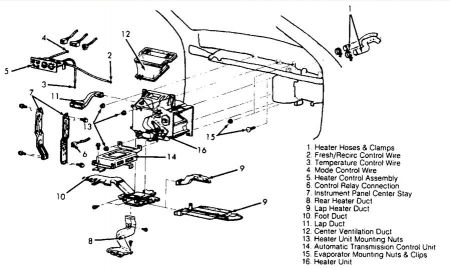

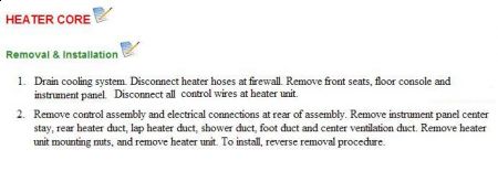

just need a brief explanation on how to replace the ehater core? Im a little lost on where it is and how to replace it NEED AN ANSWER SOON.. WINTER IS COMING!!! thanks guys!!

https://images.2carpros.com/forum/automotive_pictures/261618_Noname_1209.jpg

https://images.2carpros.com/forum/automotive_pictures/261618_Noname_1210.jpg
https://images.2carpros.com/forum/automotive_pictures/261618_Noname2_355.jpg
https://images.2carpros.com/forum/automotive_pictures/261618_Noname3_136.jpg
