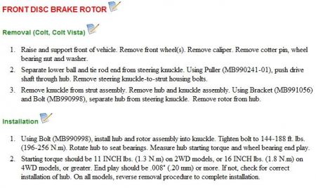

Hello, how do you remove the front rotors on an 89 dodge colt vista with a 2.0 liter engine?

May 10, 2010 at 3:29 PM
