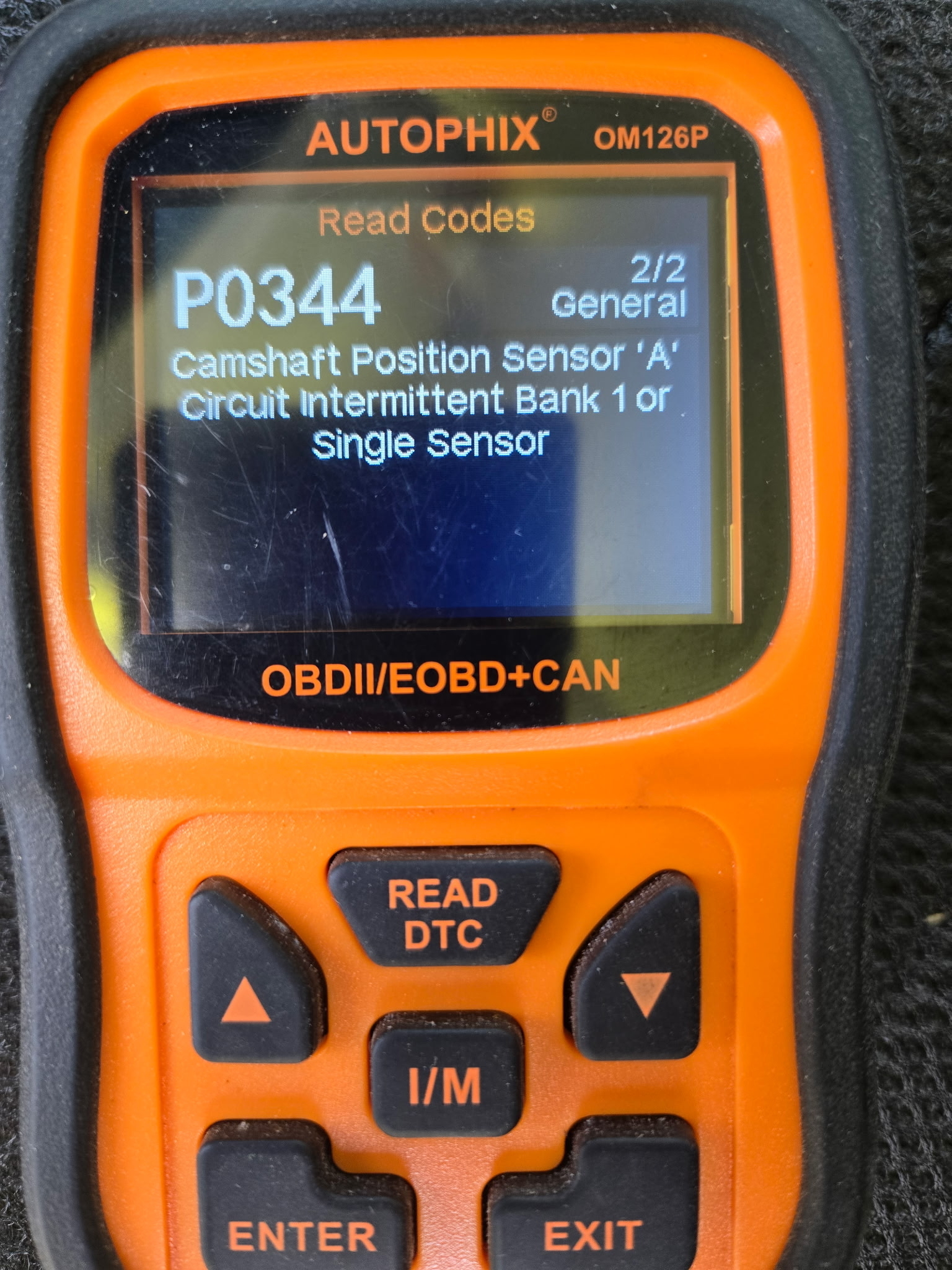

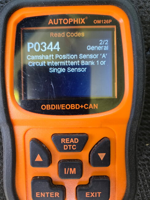

Yes the check engine light is on, and the below image is what the code reader showed.

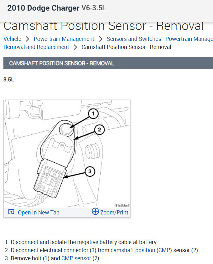

Nice work, So with the low power and this code we can try replacing the camshaft position sensor, but I can tell you if the timing chain has jumped it will show this code and the engine will have low power. Also, the ABS system does not need to be driven to have the lights off. You might want to try another repair garage. Please clear the codes once the repair as been made. Check out the images (below).
