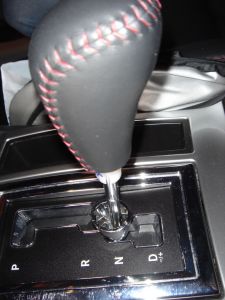

Im trying to replace the gear shift nob in my car and i cant figure out how to take it off to put on my new one. Can you tell me how or give me a website that can please.

On the bottom of your shifter is a chrome bezel.Insert a screwdriver between the shifter itself and the chrome bezel and twist the screwdriver.The bezel should release from the shifter knob and slide down.Then just pull and the knob will come off.
https://images.2carpros.com/forum/automotive_pictures/1639_dodge1_3.jpg
https://images.2carpros.com/forum/automotive_pictures/1639_dodge2_1.jpg
