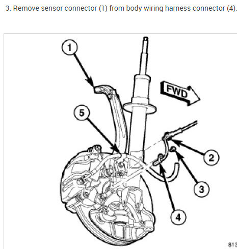

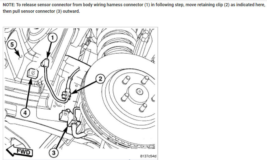

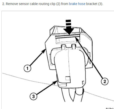

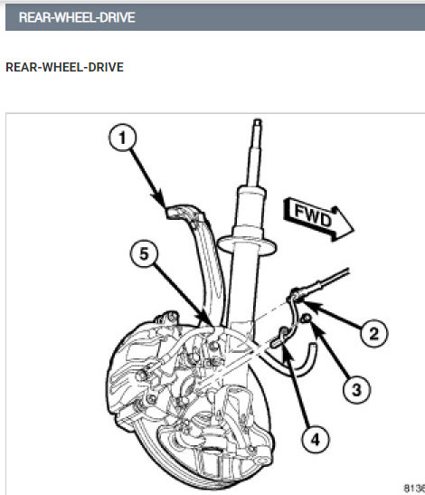

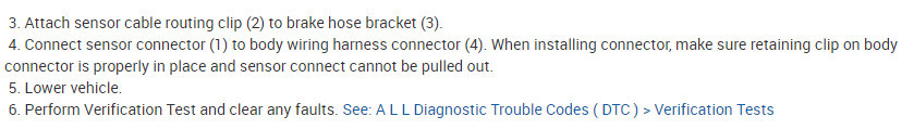

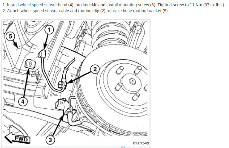

Here is the information you requested. This is a tutorial for you to view on how to replace a wheel speed sensor:
https://www.2carpros.com/articles/how-to-replace-an-abs-wheel-speed-sensor
I've attached picture steps below on how to replace the front wheel speed sensor on your car. Hope this helps and thanks for using 2CarPros.

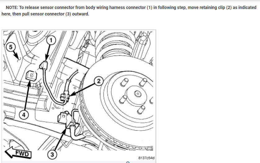

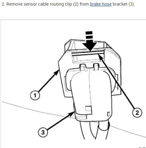

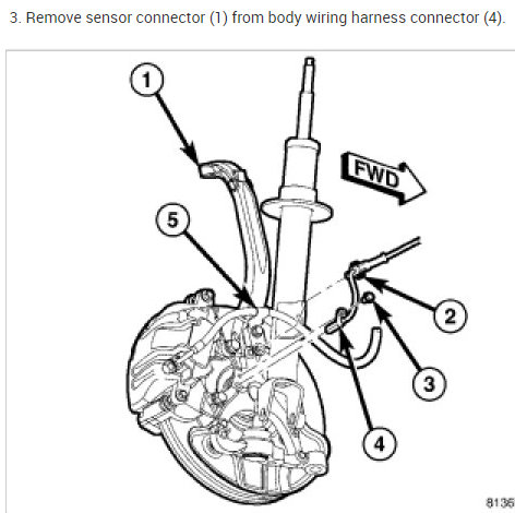

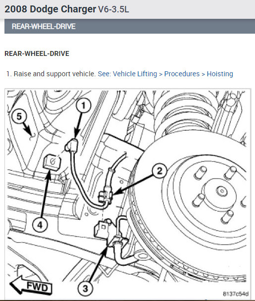

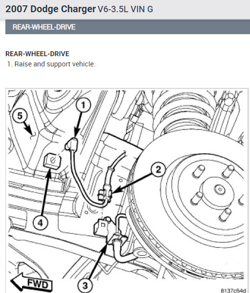

Here is the information you requested. Here is a guide to help you step by step with instructions in the diagrams below to show you how on your vehicle:
I've attached picture steps below on how to change the wheel speed sensor on your vehicle. Hope this helps and thanks for using 2CarPros.
