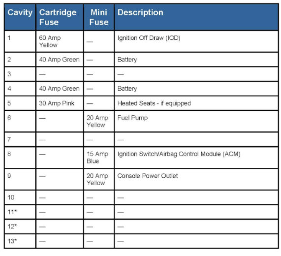

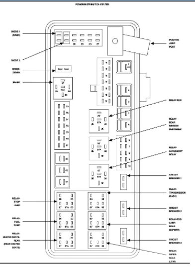

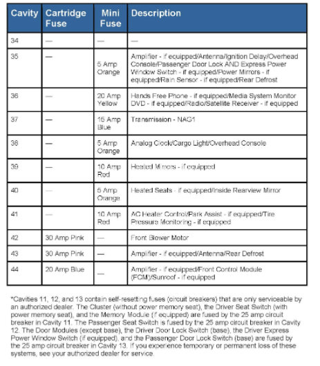

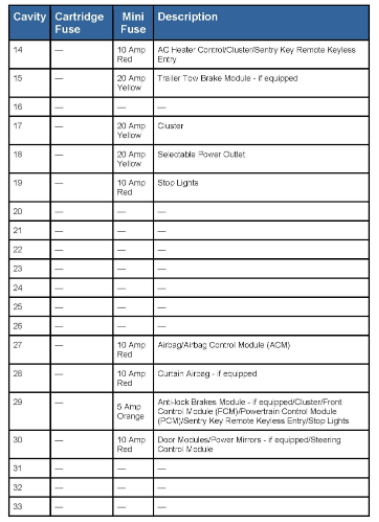

how many fuses do I have and where are they how do I check them?

Here is the information you requested. Here are a few tutorials for you to view on how to check and replace fuses:
I've attached pictures below showing the fuse and relay locations on your car. Hope this helps and thanks for using 2CarPros.
