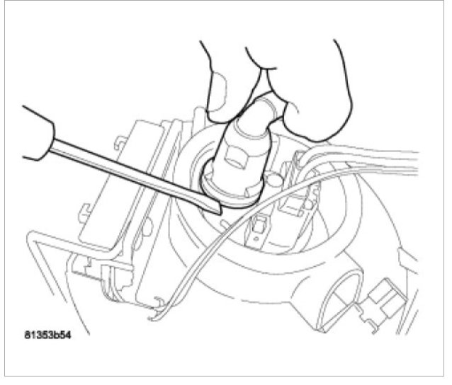

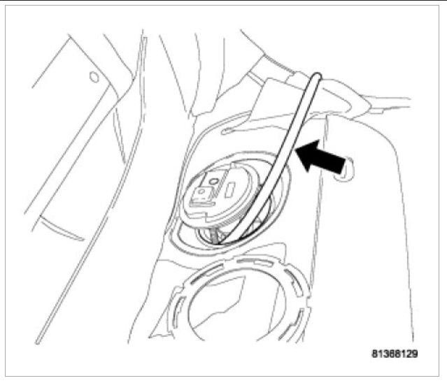

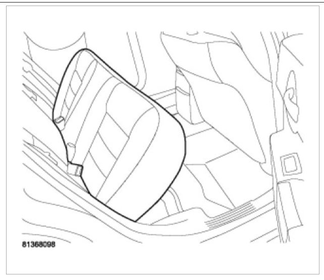

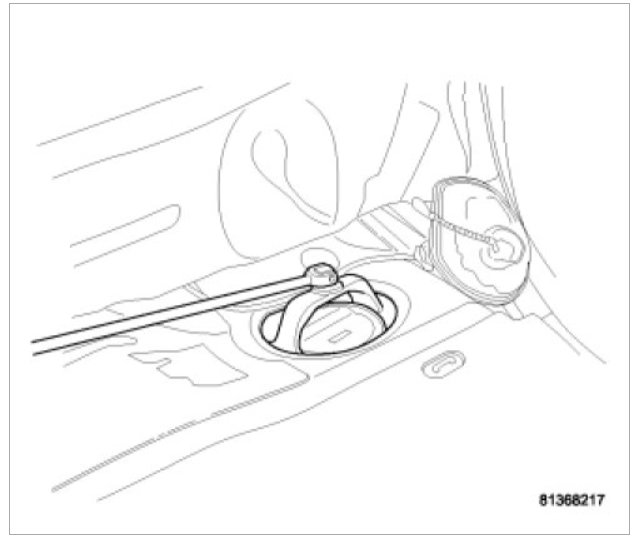

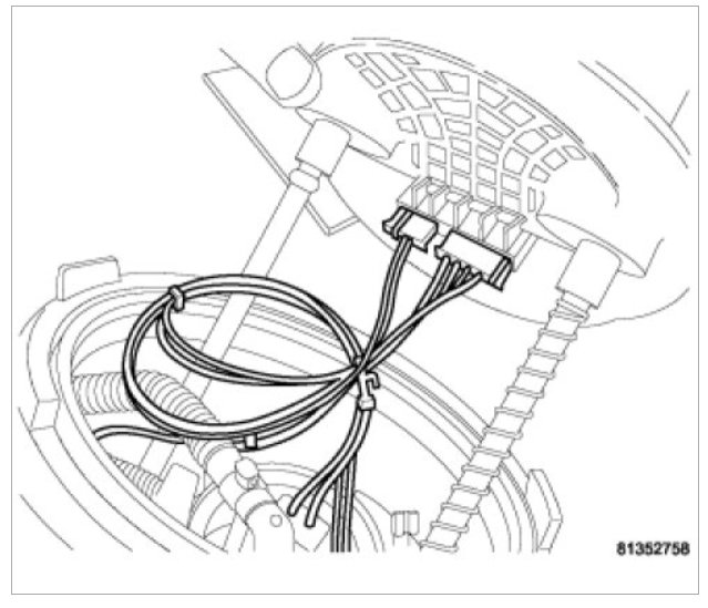

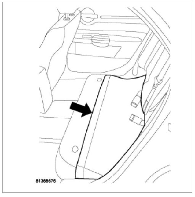

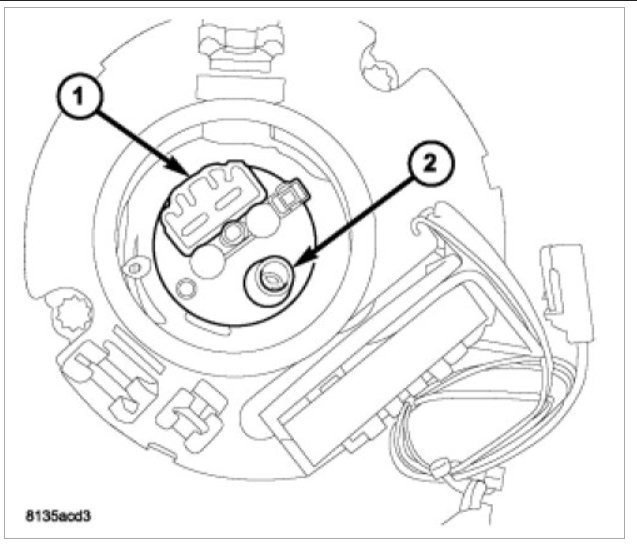

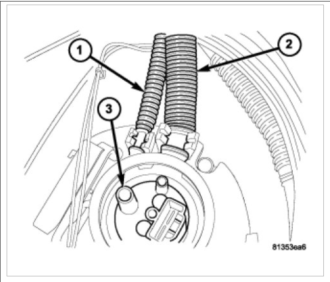

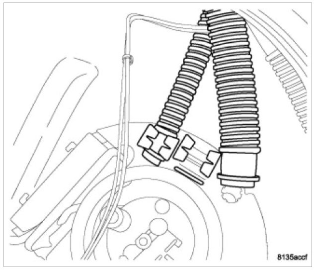

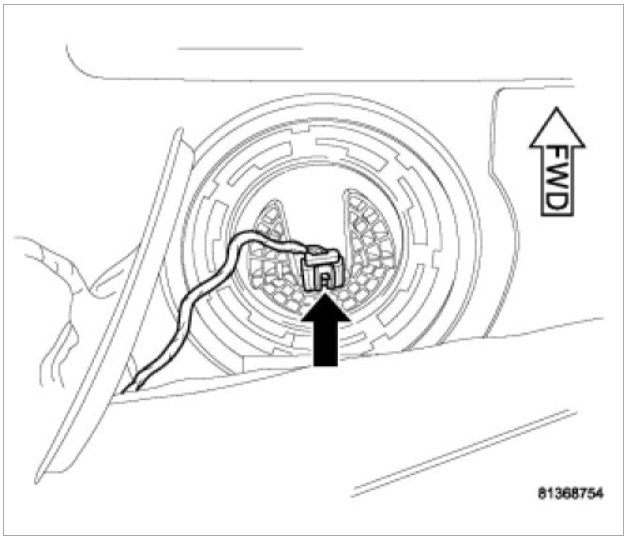

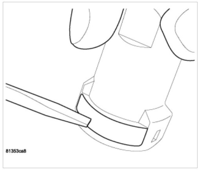

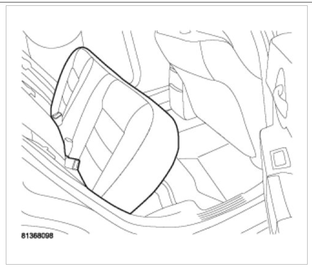

Can you tell me where is the fuel filter on a 2007 dodge charger?
Oct 23, 2009 at 4:06 PM
  • 55,433 POSTS

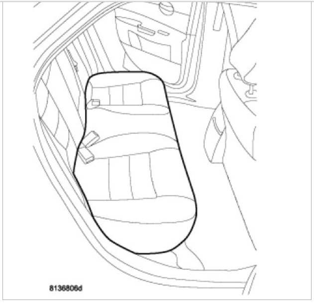

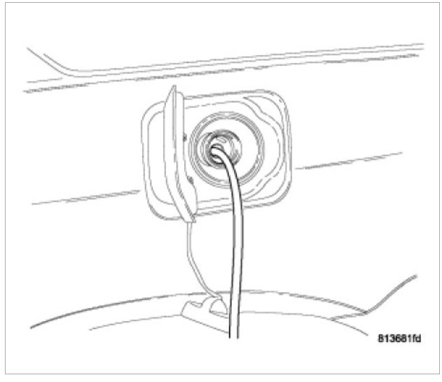

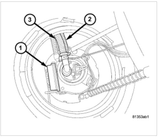

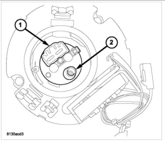

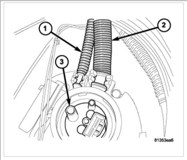

The fuel filter for your car is located in the fuel tank with the fuel pump. You will need to drain the fuel down a bit before you remove the fuel pump. Here is a guide that will show you what you are in for when doing the repair except your car has an access hole under the back seat so you don't need to remove the fuel tank.
https://www.2carpros.com/articles/how-to-replace-an-electric-fuel-pump
Here is a video on how to drain some of the gas out.
https://youtu.be/Q5MH2gnyFH0
Here is what it will be like for your car (below)
