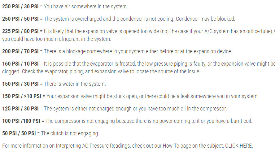

my car's A/C has never been very cold. so i thought i would add a can of 134 and after i did it blows warm then cold. did i over charge it ? or do you think there is another problem?
Jun 19, 2010 at 8:03 AM
Yes. More then likely it is overcharged however, we need to test the pressures in order to figure out what is going on. Here is a guide that will help with this:
Also, here is a guide that will help with this issue as well. It talks about the common causes of these issues.
lastly I attached the proper pressures and the common issue depending on what the pressures are so let's get those and go from there. Thanks
