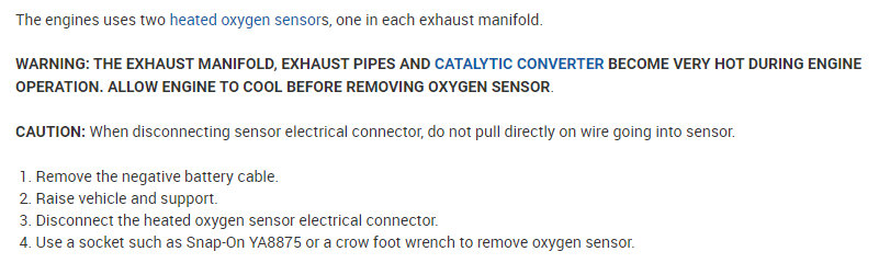

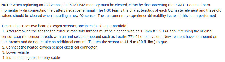

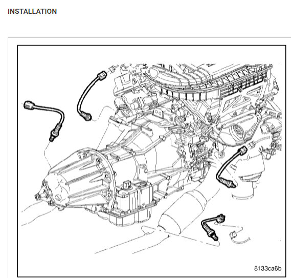

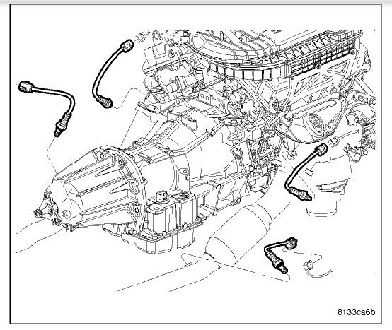

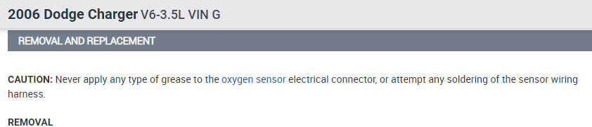

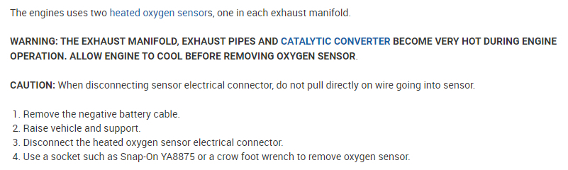

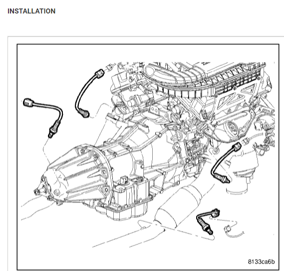

I am no expert by far, I have this o2 sensor problem that I have been reading about. However, I dont know where the sensors are can help help?
Dec 11, 2009 at 7:24 PM
DANNY L
  • 5,648 POSTS
Hello, I'm Danny.

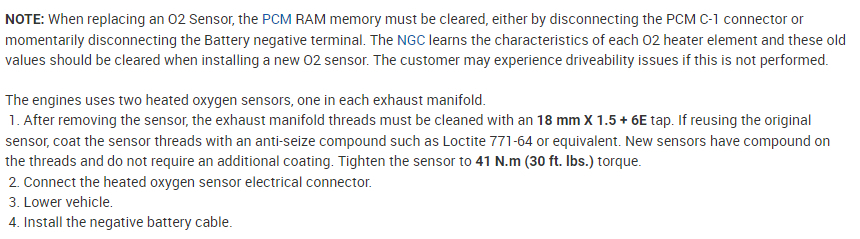

Here is the information you requested. Here are tutorials showing how to test and replace oxygen sensors:
https://www.2carpros.com/articles/how-to-test-an-oxygen-sensor-02-sensor
https://www.2carpros.com/articles/how-to-replace-an-oxygen-sensor
I've attached picture steps below on how to replace the oxygens sensors including their locations on your car. Hope this helps and thanks for using 2CarPros.
