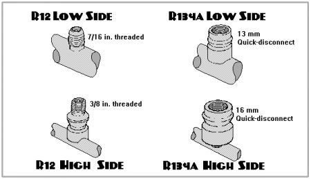

Find the fittings/ports within the plumbing
https://images.2carpros.com/forum/automotive_pictures/12900_ac_service_fittings_20.jpg
