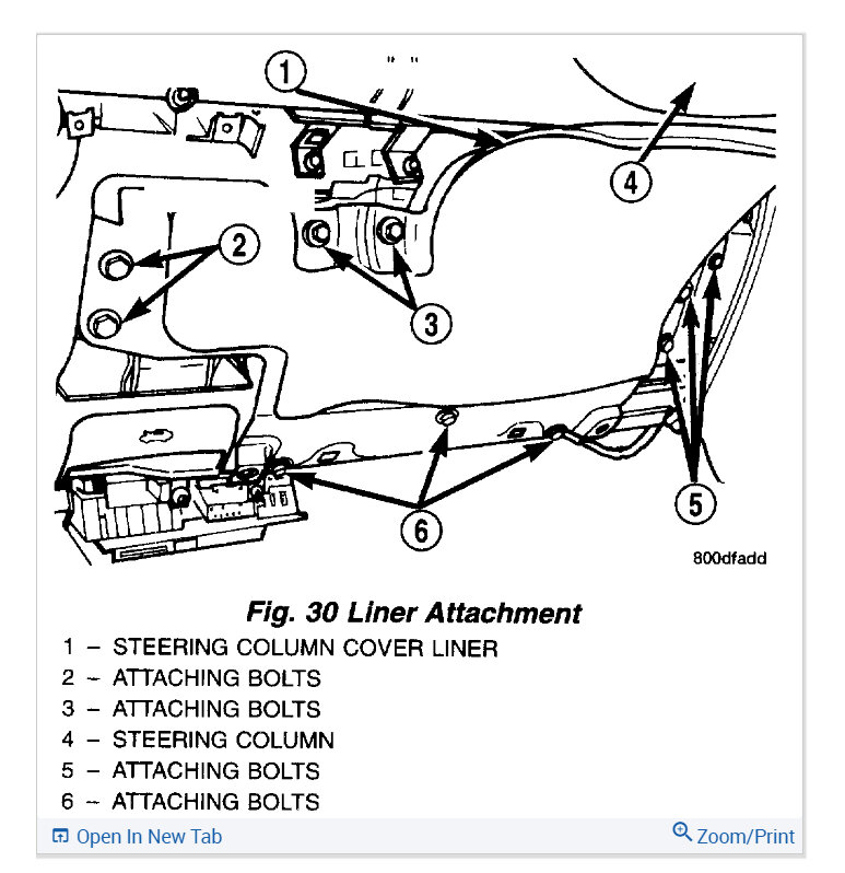

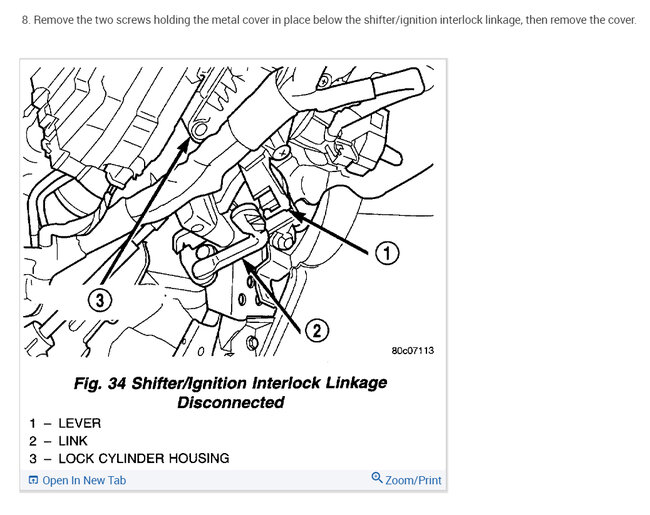

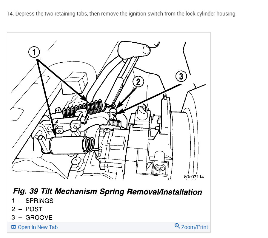

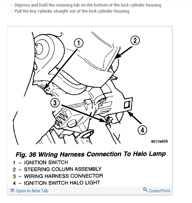

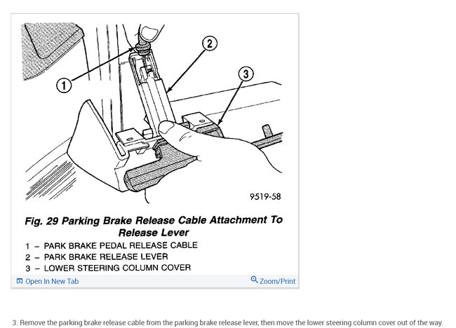

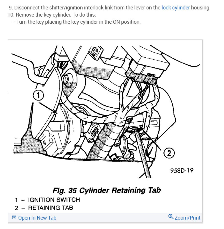

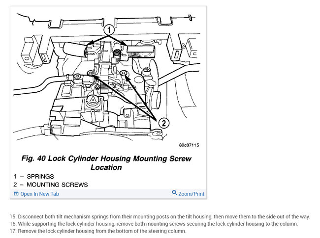

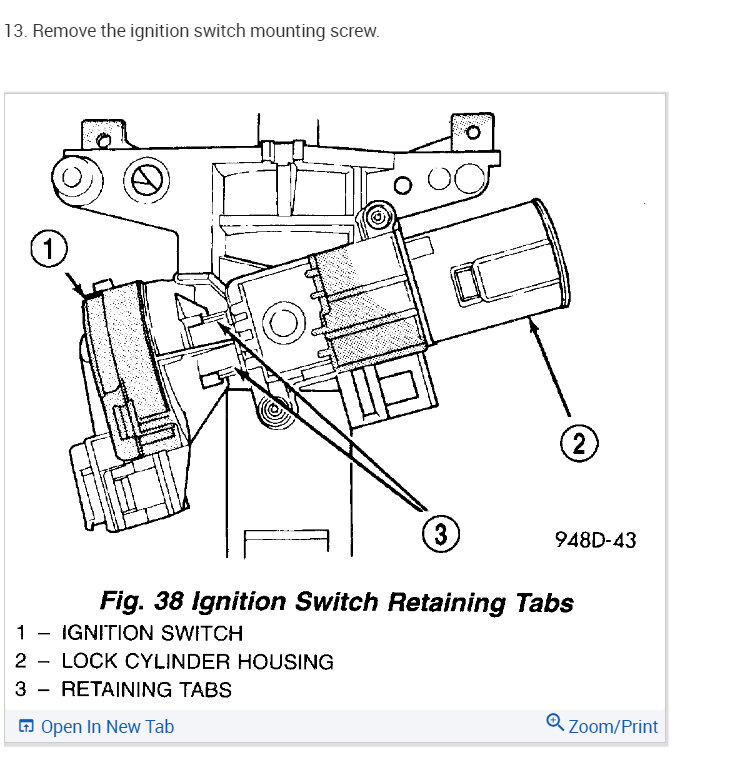

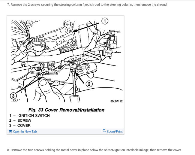

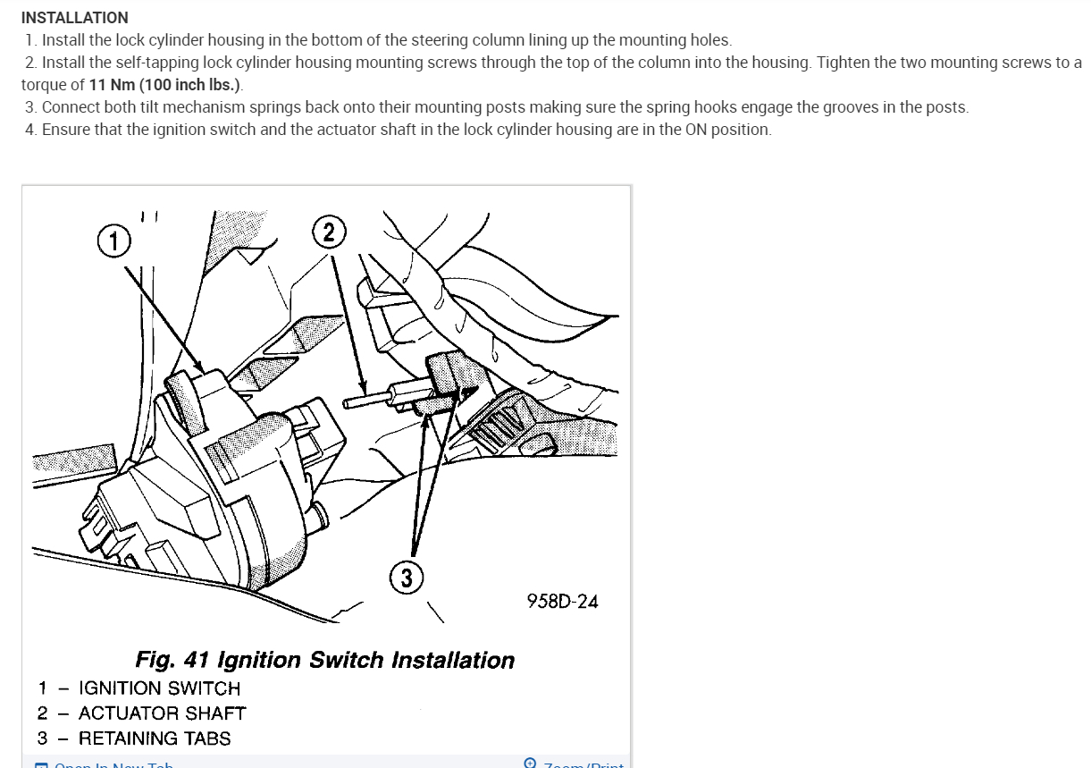

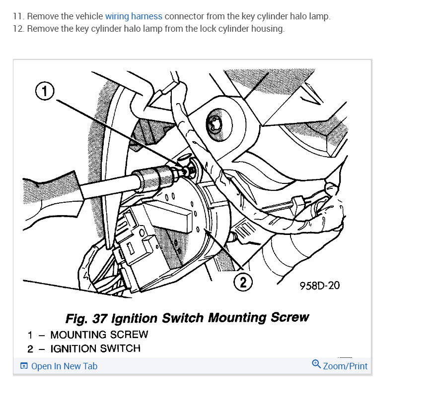

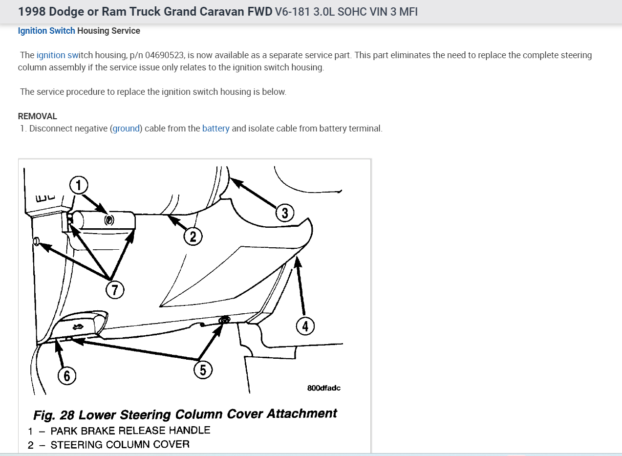

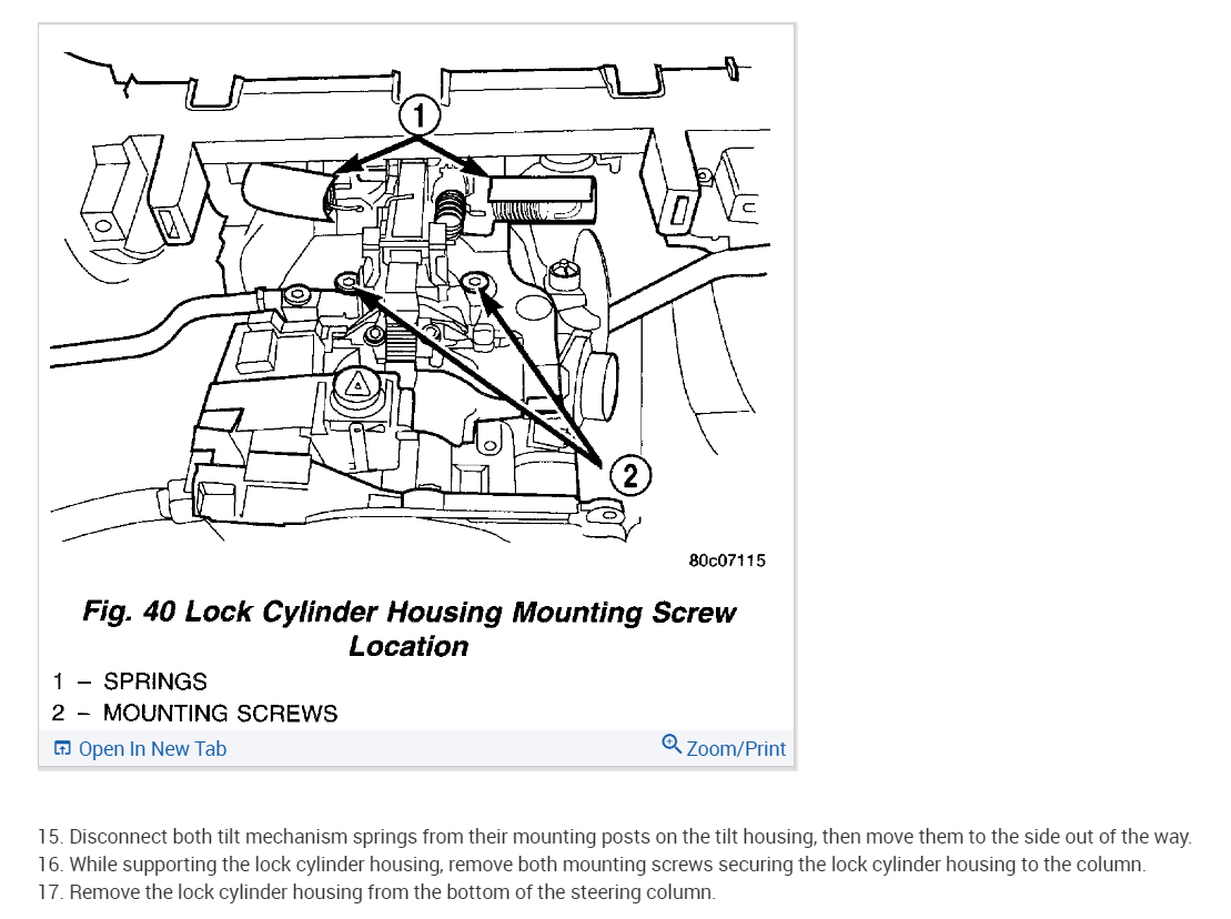

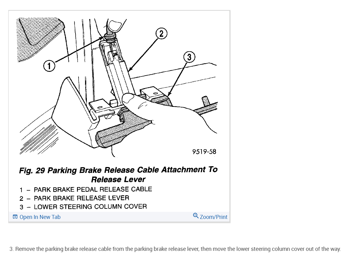

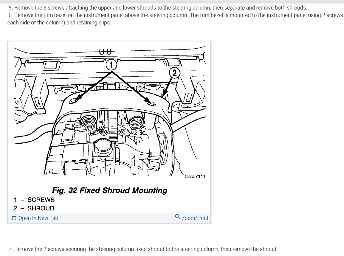

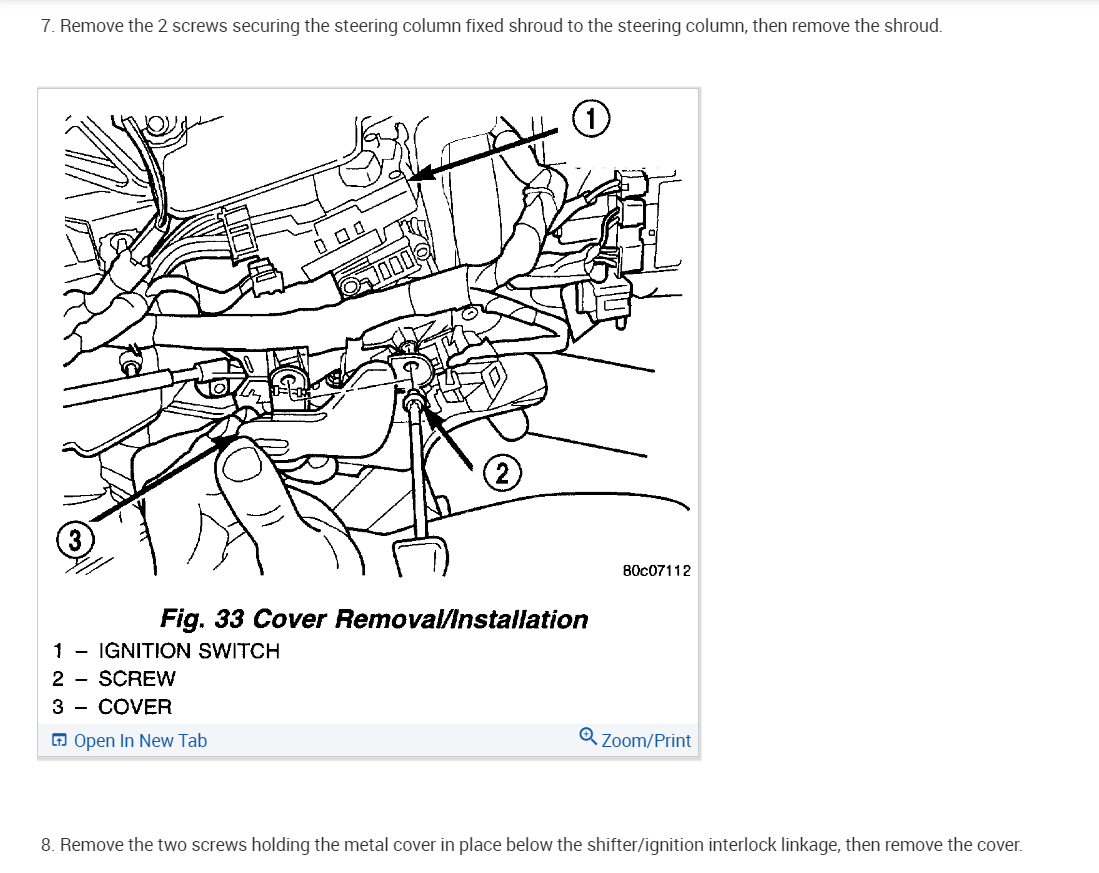

my steering wheel turns but does not lock. i can hear a clicking sound where it should lock,but the ignition wont turn do to pressure as though the steering is bound
Dec 8, 2022 at 9:17 AM
  • 55,682 POSTS

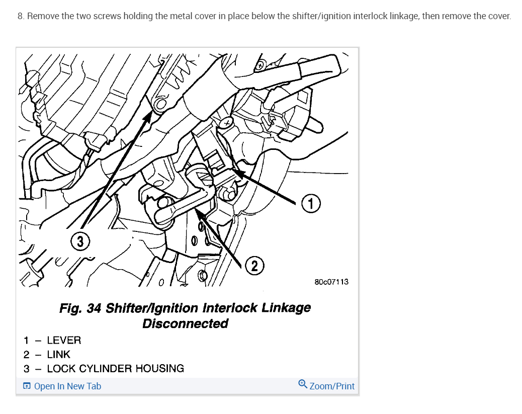

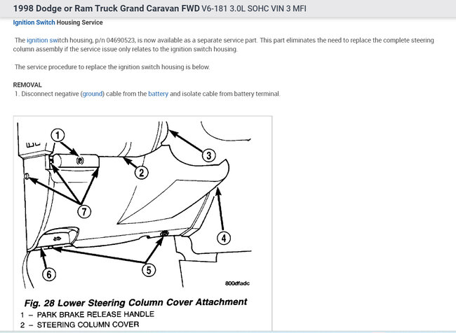

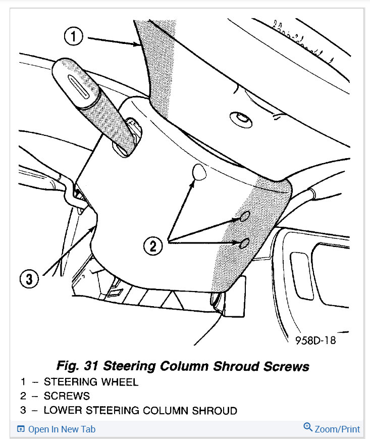

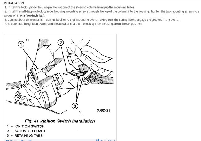

What happens is the lock becomes worn and allows the locking pin not to be fully engaged. Here are the instructions on how to change the lock out. Check out the images (below). Please let us know if you need anything else to get the problem fixed.
