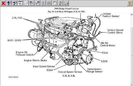

SPEED SENSOR LOCATION
STAN1955
HI I HAVE A DODGE GRAND CARAVAN YEAR 2000 WITH A 3.3 L ENGINE AND A 3 SPEED AUTOMATIC TRANMISSON. WHERE IS THE SPEED SENSOR LOCATED. THANK YOU FOR YOUR TIME

Dodge calls it output speed sensor, see below
https://images.2carpros.com/forum/automotive_pictures/12900_2000_dodge_grand_caravan_output_speed_sensor_1.jpg
