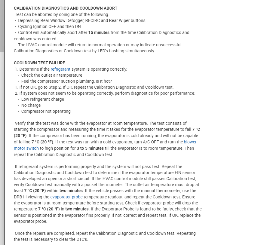

A/C works fine. FYI, the radiator, cap, thermostat are all working well, and coolant is full.
Details:
1) No heat; switching from cool to heat is warmer, but not even close to 70 degrees, unless the ambient temperature is 70 or warmer.
2) When sliding the (single, not dual) cool/heat from cool to heat, the volume (even at high) drops more than 50%.
3) Fan setting 4 (of 5) is the same as Off.

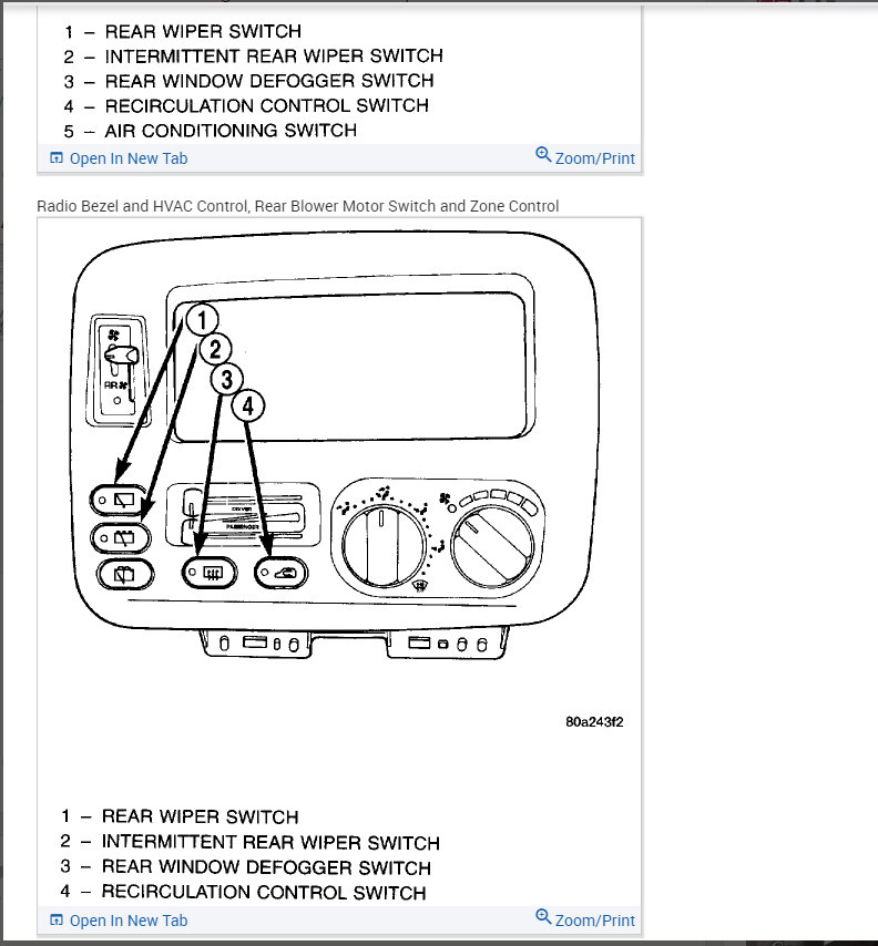

4) I have attempted the Control Panel reset suggested elsewhere; when it is done, the Recirc and A/C On/Off lights are flashing.
Does this suggest a failure with the entire Control Panel or something else?
Oct 20, 2021 at 4:23 AM

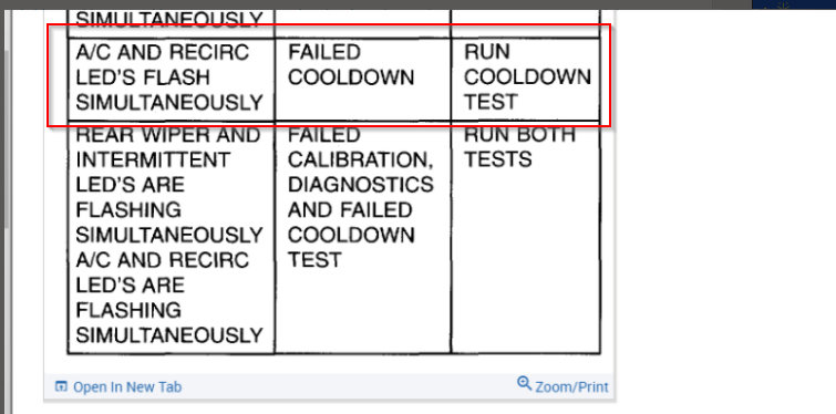

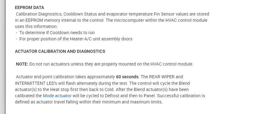

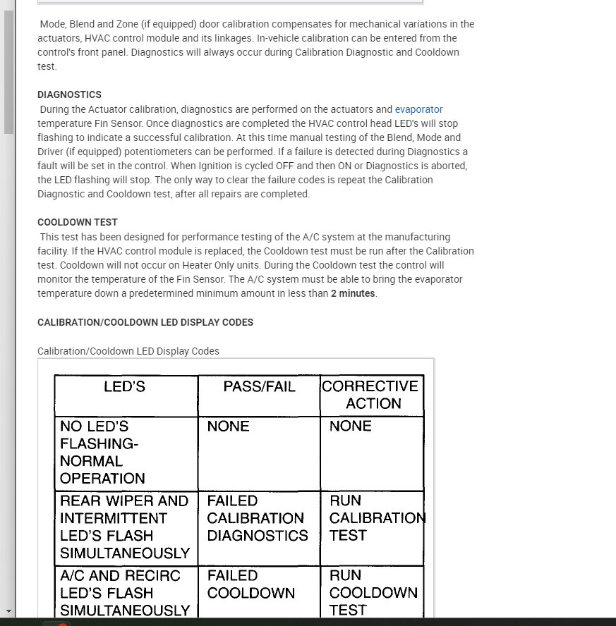

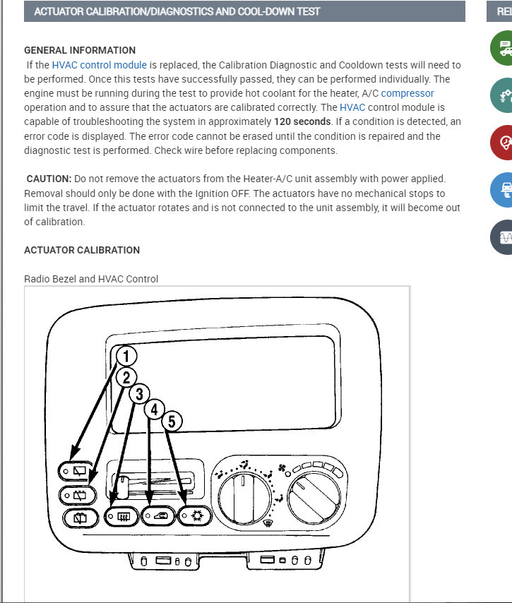

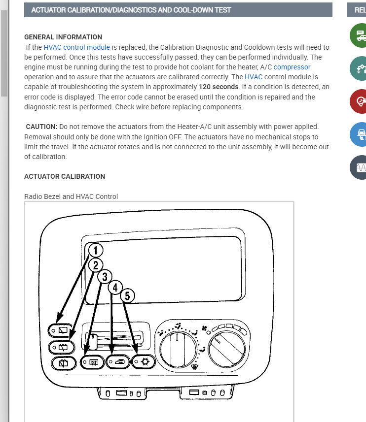

Yes. The A/C and recirc door flashing means the cooldown test failed so we are going to need to run through this info.
This may need a control module but there are other possible causes, so I am attaching the testing below.
Please run through this and let us know what other info you need. Then let us know what happens and we can take next steps.
If the cooldown test fails, then we need to check the A/C pressures so here is a guide that will help with this.
Please let us know what happens. Thanks

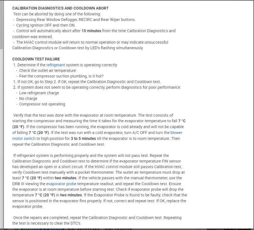

These flashing lights mean you are failing the cooldown test, so we need to run through this info I am attaching in order to figure out what is next.
I doubt flushing the heater core will change anything so take a look at this info attached and let me know what you find.

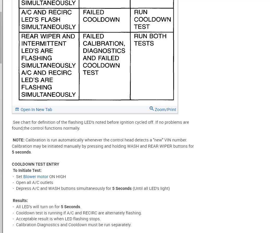

Okay. If you reran the test and the lights did not flash at the end, then this means it passed.
As the A/C lights and recirc lights still flashing all the time now? If you just don't have heat, then have you removed the blend door actuator and move the door manually to see if the door can actually move to give full heat? If so, then the actuator is clearly not moving. This also proves the heater core is not the issue.
Another way to prove a possible heater core issue is to measure the temperature of the lines going in and out of the core. They should be pretty close in temperature. If not, then you have a restriction.

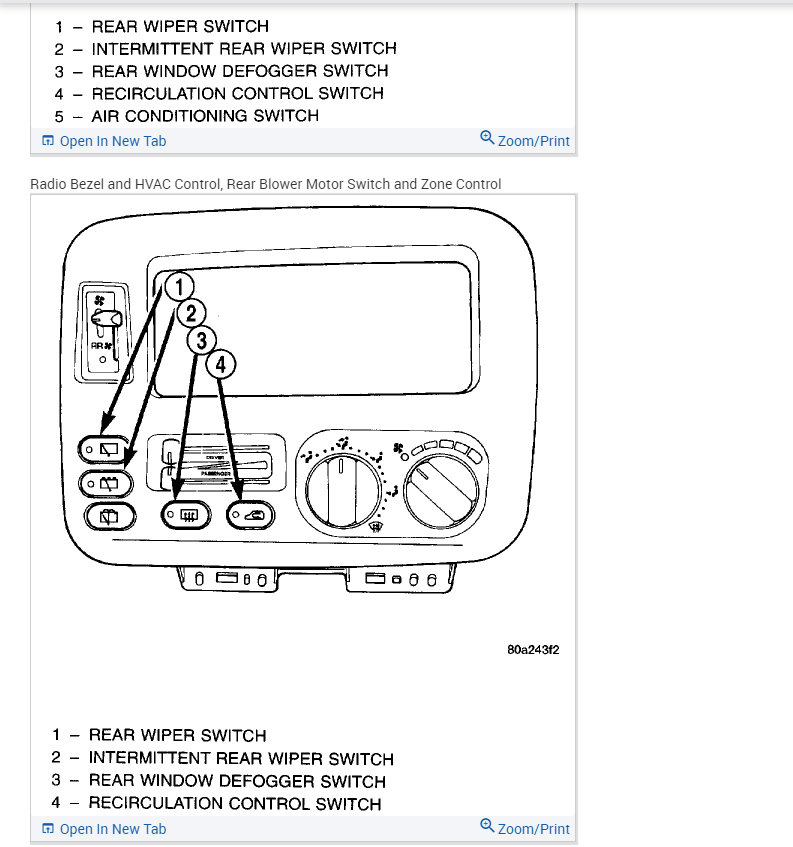

However, if you are willing can you get a video of what is happening when you run this test?

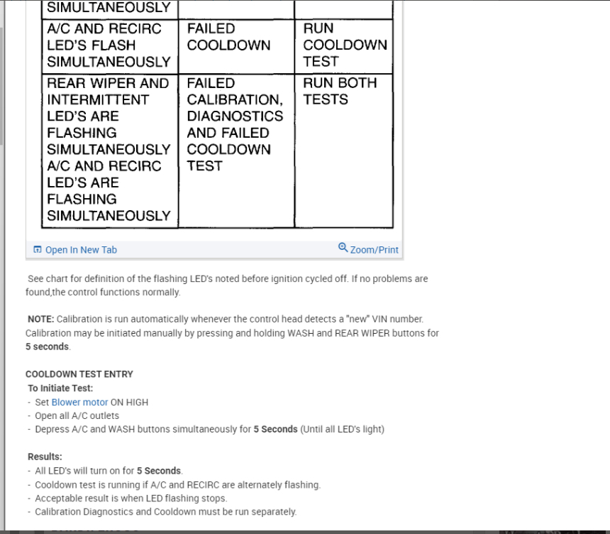

Press the A/C and Wash button at the same time for 5 seconds and all the lights should come on.
Then the A/C and recirc should flash one at a time and if all the lights go off and do not come back on then it passed the test.

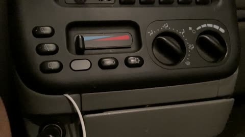

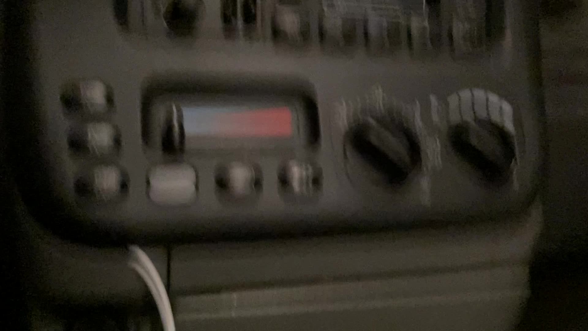

BARDIFEROUS
  • 5 POSTS
Videoed the test, twice. First, with fan off; second, with fan on high. First one finished with A/C and Recirc flashing. Second finished with all lights going out.
No change in any of the issues.

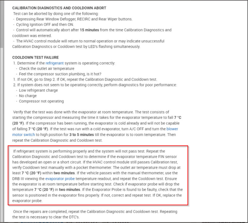

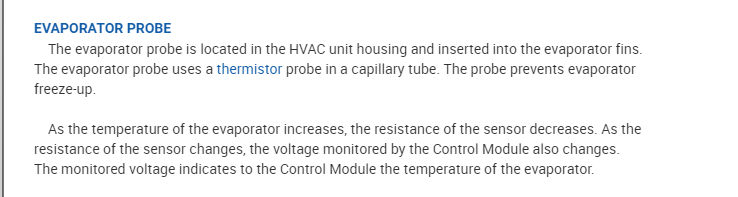

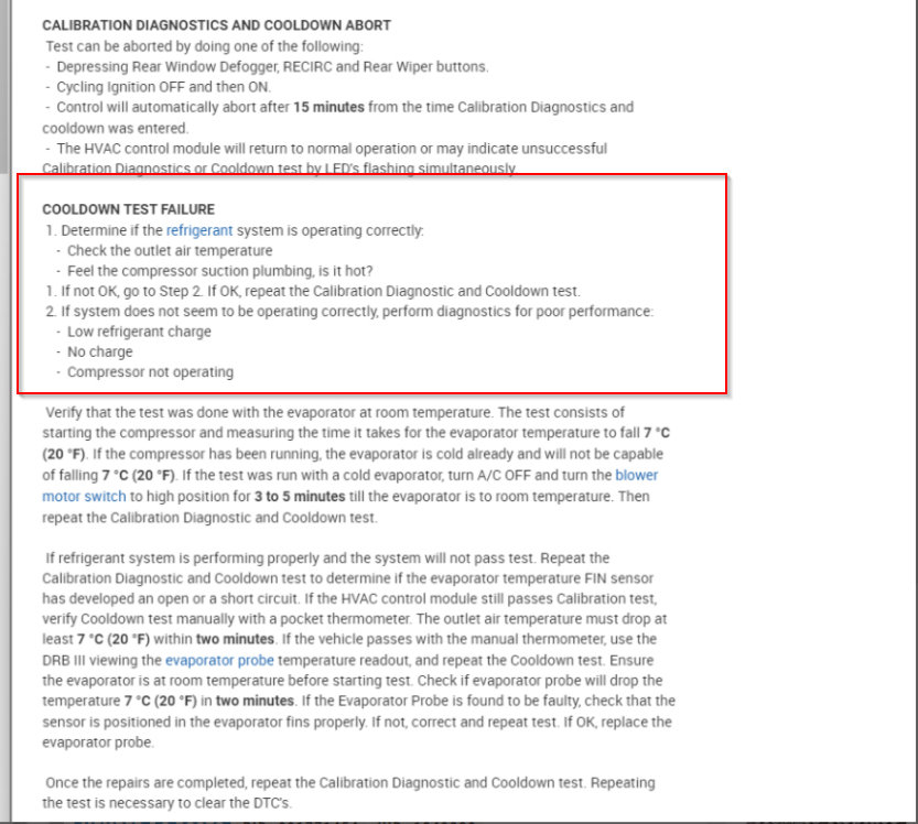

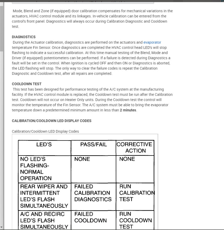

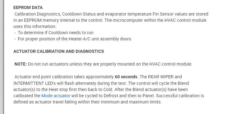

Perfect. You are in fact failing the cooldown test. I suspect you have an issue with the evaporator temp sensor.
The first thing we need to do just so that we are sure this is the issue is make sure the A/C pressures are correct. Due to you have an issue with changing temperature of the air I don't think this is going to be an issue but we should make sure as it is pretty easy to rent a set of manifold gauges and hook them up just to make sure the compressor is working properly.
However, take a look at the last two attachments. This address what I suspect your issue is. When you fail the cool down test and the A/C system is properly charged, it has you address the temp sensor.
Based on all this, I suspect this probe/sensor will need to be replaced.
