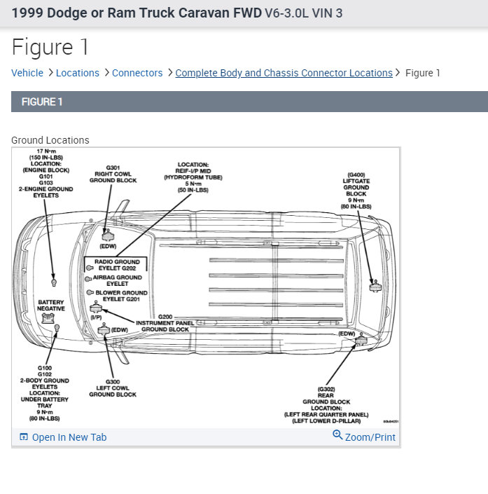

I need to know how many ground wires there are and where they are located please?
DODGE CARAVAN
RUBY

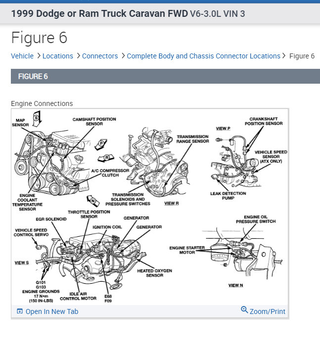

I have a 1999 dodge grand caravan 3.0L engine. I need to know how many ground wires there are and where they are located please. In the process of replacing the engine one ground has fell off and not sure where it goes.

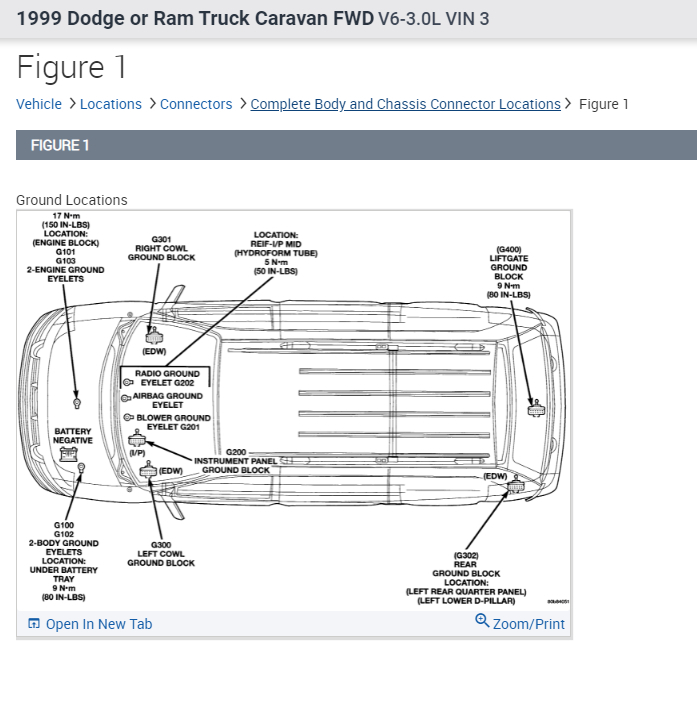

Under the hood there are 2 primary ground cables for the engine harness. However, there are other for different components.
I have attached diagrams showing the engine ground wires below.
