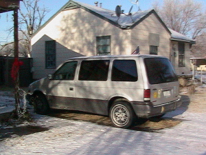

1991 Dodge Caravan ES 3.3L engine with 222.060 miles on it....................... Ok this time I really paid attention.......... MY MISTAKE NOT THE TRANS!!!!! Van ran good the 12th and the 13th (cooler days) but Yesterday the 14th was in the 70s again, Took the van drove it 5 blocks and filled the gas tank, then I drove it about 5 miles more to my husbands work, shut it off waited for him about 5 minutes. restarted van (Speed Limit is 10 mph in parking lot) got to the security gate and the motor started running a little rough and WOULD NOT GET ANY POWER, So I pulled over to the side put it in park, Motor ran rough enough to give just a slight shake to van NOT MUCH THOUGH, But you knew it was there. waited about 2 minutes the problem went away and van ran fine... No check engine light came on, van did not die but did act like it was going to. have not changed out the Fuel pump yet $173.00 it is on my list though. is there anything else that could also cause this problem? Would like to get this all changed at once. Here is my Baby :cry:
https://images.2carpros.com/forum/automotive_pictures/63666_My_Picture_028300_1.jpg
