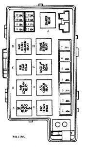

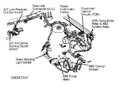

I have a 94' Dodge caravan. The cooling fan will not come on causing the engine to over heat. I suspect a bad relay, but i don't know where they are located.
