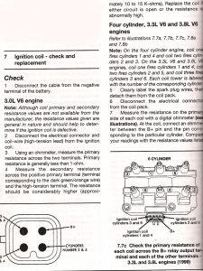

see if this will help you mike
https://images.2carpros.com/forum/automotive_pictures/54223_coil_res_dodge_caravan_1.jpg
