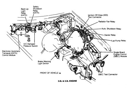

Got a 92 caravan,3.3 v 6.automatic.It wont shut off when you turn the key offThe ignition switch,and tumbler have been replaced.Any ideas on this??Thank you..Mike

Try the 2 relays in the picture auto shutdown and starter relays
https://images.2carpros.com/forum/automotive_pictures/62217_92CaraRelays_1.jpg
https://images.2carpros.com/forum/automotive_pictures/62217_30961_mitchell_2_13.jpg
