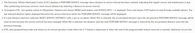

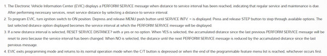

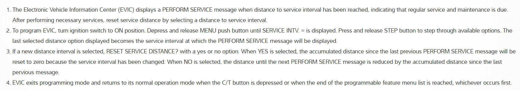

Hi, my name is Alex and I will be helping you.
I am not sure which of these apply to your year of vehicle so I included all of them. Please let us know which one it was, and thank you for using 2carpros. Alex.
