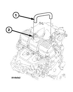

where can I find this valve? I think that is where my oil leak is. I am using oil - no spots in the garage and I am not burning oil - just using it!

The PCV won't cause the use of oil. It will be located on the valve cover. Here is a general picture of one:
https://images.2carpros.com/forum/automotive_pictures/249084_PCV_3.jpg
Can you tell me how many miles you drive before you use a quart of oil? Check out the diagrams (Below). Please let us know if you need anything else to get the problem fixed.

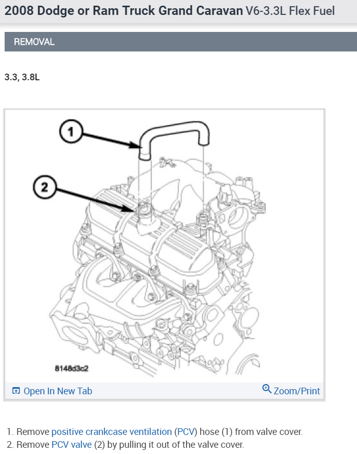

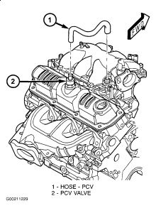

Where is the PCV Valve located on the 3.8L engine?

https://images.2carpros.com/forum/automotive_pictures/55316_03caravanpcv_1.jpg

I failed smog because of a cracked PCV hose. Where is this hose located?

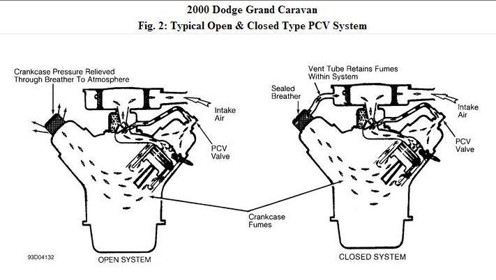

most likely, the pcv snaps into a valve cover as in most vehicles
i did look thru "mitchell i" for about 30 minutes. below is the only diagram i could find on "pcv" for your rig
if you are still lost---take a pic of both sides of your engine---maybe i can identify it for you that way easier than that! a parts store should be able to point it out for you in person!

the hose should run to the PCV valve on the valve cover.

Well I figred the same thing. I will have to take a look at the rear cover because it's not in the front. Thanks for your time.
