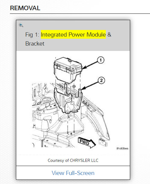

After driving, I stop my car in the driveway, unhook my seatbelt, and open the sliding van door. The car is still running. I unload my packages, get back in the car. The windshield wipers start automatically and the multiple lights appear on the dashboard and the seat-belt chime goes off. This climate does not stop until I turn the engine off. this does not happen every time. I've tried to repeat this for the dealership service people - of course not.
Thanks for your assistance
Sep 16, 2010 at 7:42 AM
  • 110,244 POSTS

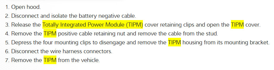

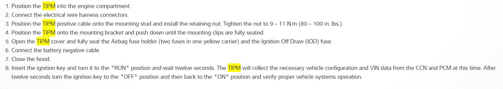

This is a common problem when the TIPM goes out which is common but you are in luck because it is easy to replace because it self initializes. Here are the instruction in the diagrams below to show you how. Check out the diagrams (Below). Please let us know what happens.
Sep 17, 2010 at 12:02 AM
TURBOJAY
Thank you for this post I had this problem and had to replace the TIPM cost me $234.00 all fixed I love this site.
