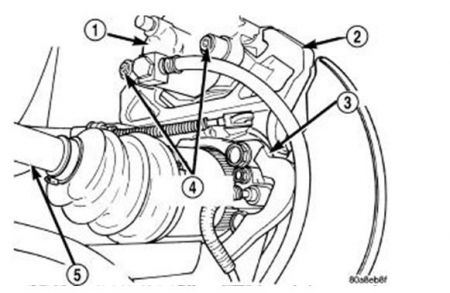

Front brakes a breeze. How do I get the caliper and rotor off to change the rear brakes? Can't find the bolts that holds the caliper on. Any help is greatly appreciated.
