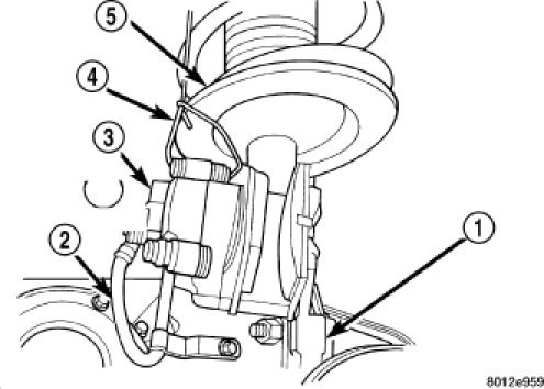

CAUTION: Supporting weight of caliper by the flexible brake fluid hose can damage the hose.
7. Using wire or cord, hang the caliper from the front strut assembly (Figure 1). Support the caliper firmly to prevent weight of caliper from being supported by the brake fluid hose.

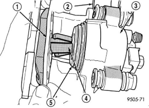

9. Pull the inboard brake shoe away from the caliper piston until the retaining clip on shoe is free from the cavity in the caliper piston (Figure 2).

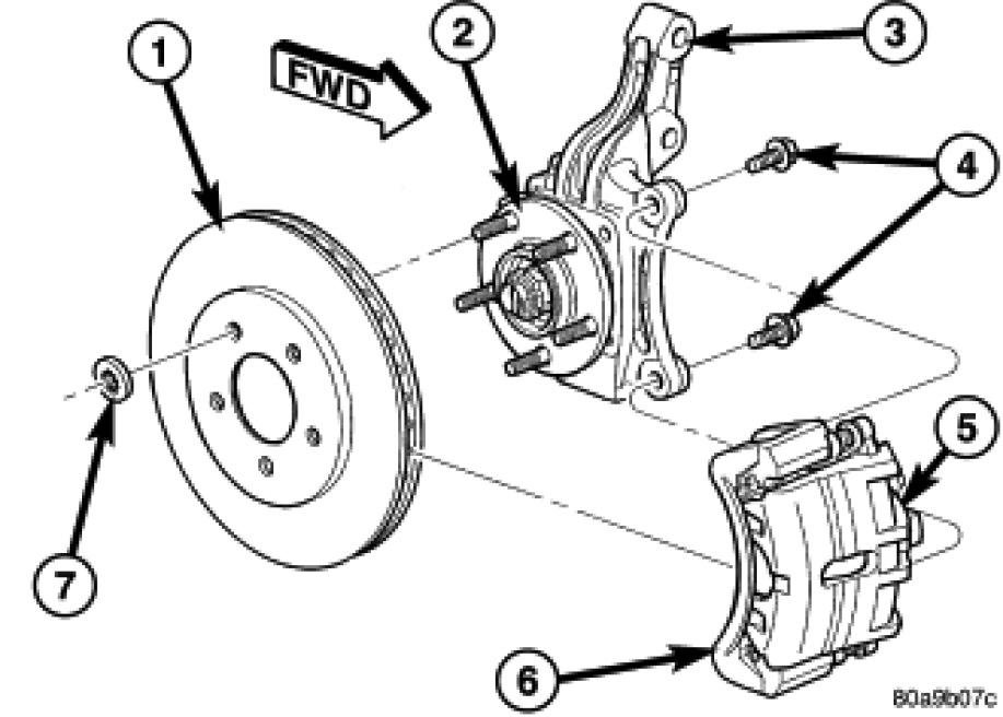

INSTALLATION - FRONT BRAKE ROTOR
1. Install the brake rotor back on the hub and bearing (Figure 1).
2. Install brake caliper and adapter back over brake rotor aligning adapter with mounting holes on steering knuckle (Figure 1).
3. Install the two adapter mounting bolts securing the adapter to the steering knuckle. Tighten the mounting bolts to 169 Nm (125 ft. lbs.) torque.
4. Install wheel and tire assembly on vehicle. Tighten the wheel mounting lug nuts in proper sequence until all nuts are torqued to half specification, then repeat the tightening sequence to the full specified torque of 135 Nm (100 ft. lbs.).
5. Lower vehicle to the ground.
