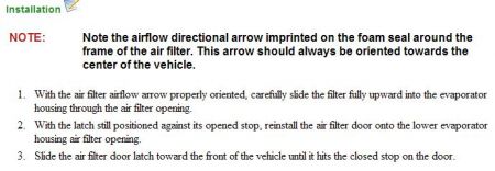

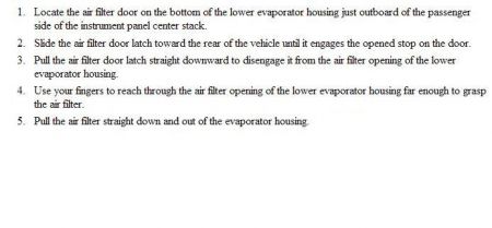

How do I change the air conditioner filter?
How often should it be changed?

Replace every 12,000 miles

Very detailed answer. Thanks so much.
