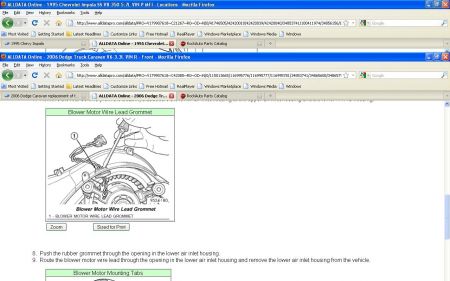

How is the best way to remove and replace the front blower motor for the heater/air conditioner.

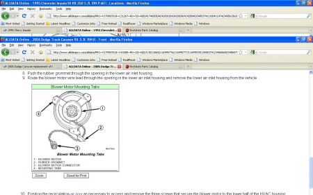

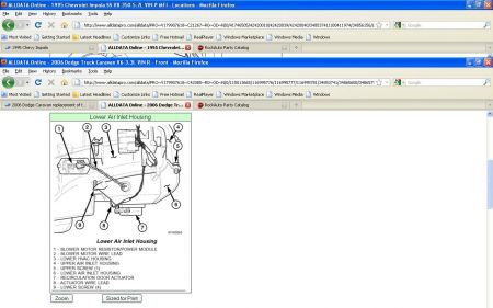

2006 Dodge Truck Caravan V6-3.3L VIN R REMOVAL NOTE: The blower motor is located on the passenger side of the vehicle under the instrument panel. The blower motor can be removed from the vehicle without having to remove the HVAC housing. 1. Disconnect and isolate the negative battery cable. 2. Remove the passenger side cowl trim panel. Lower Air Inlet Housing 3. Position the carpet to access the front upper screw that secures the air inlet housing. 4. Remove the recirculation door actuator. 5. Disconnect the blower motor wire lead connector from the blower motor resistor or power module, depending on application. 6. Remove the one screw (from the top) that secures the lower air inlet housing to the upper air inlet housing. 7. Remove the four screws (from the bottom) that secure the lower air inlet housing to the upper air inlet housing and the lower HVAC housing. Blower Motor Wire Lead Grommet 8. Push the rubber grommet through the opening in the lower air inlet housing. 9. Route the blower motor wire lead through the opening in the lower air inlet housing and remove the lower air inlet housing from the vehicle. Blower Motor Mounting Tabs 10. Position the recirculation-air door as necessary to access and remove the three screws that secure the blower motor to the lower half of the HVAC housing. 11. Gently flex the recirculation-air door downward to gain access to remove the blower motor from the HVAC housing. NOTE: To aid in installation, note the position of the blower motor mounting tabs prior to removal. 12. Remove the blower motor from the HVAC housing by rotating and tilting the blower motor as necessary. INSTALLATION 1. Gently flex the recirculation-air door downward to gain access to install the blower motor into the HVAC housing. 2. Position the blower motor to the HVAC housing and tilt and rotate the blower motor as necessary to install it into the HVAC housing. 3. Align the blower motor mounting tabs to the locations noted during removal and install the three screws that secure the blower motor to the HVAC housing. Tighten the screws to 2 N.m (17 in. lbs.) . 4. Route the blower motor wire lead through the opening in the lower air inlet housing and seat the rubber grommet. 5. Position the recirculation door pivot shaft into the lower air inlet housing and install the inlet housing. 6. Install the four screws (from the bottom) that secure the lower air inlet housing to the upper air inlet housing and the lower HVAC housing. Tighten the screws to 2 N.m (17 in. lbs.) . 7. Install the one screw (from the top) that secures the lower air inlet housing to the upper air inlet housing. Tighten the screw to 2 N.m (17 in. lbs.) . 8. Connect the blower motor wire lead connector to the blower motor resistor or power module, depending on application. 9. Install the recirculation door actuator. 10. Reposition the carpet. 11. Install the passenger side cowl trim panel. 12. Reconnect the negative battery cable. 13. Perform the heater-A/C control calibration procedure.
https://images.2carpros.com/forum/automotive_pictures/416332_2006_dodge_caravan_blower_fan_motor_replacement_part3_2.jpg
First of all thank you so much for your donation.I posted the instruction's and diagrams on how to replace your blower motor.
